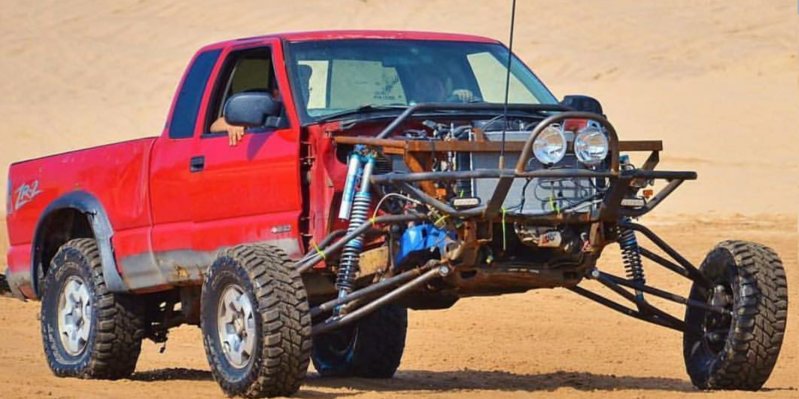

    Go big or go home bro. +36''

    Sweet. But a bit too wide for our trails in the East.
