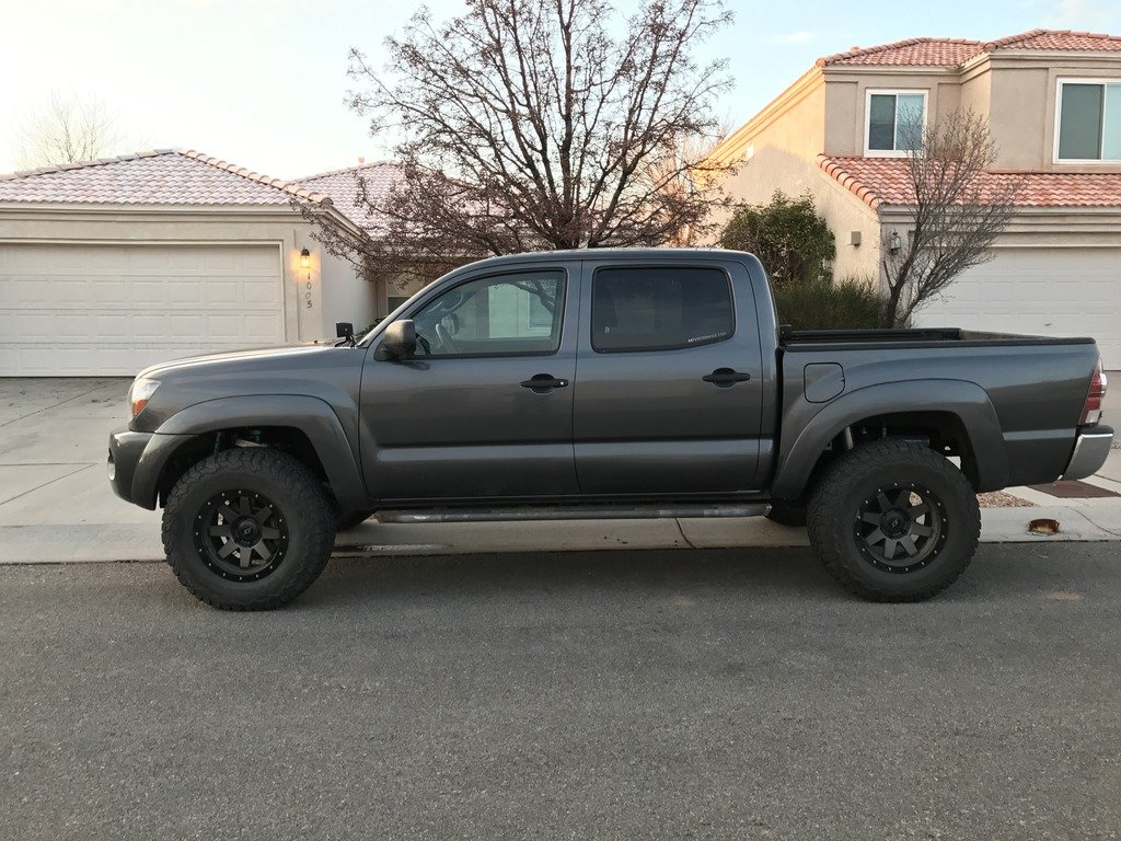

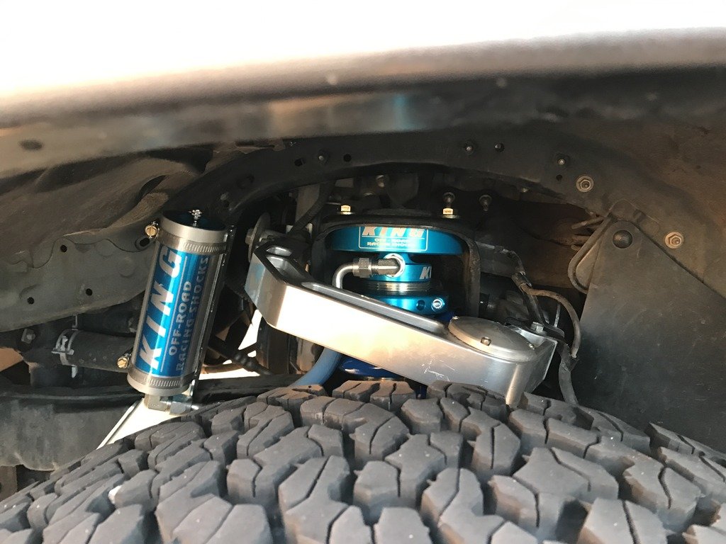

    So...you got more up travel than fender flare clearance ? Better hack those babies up before you go froadin'

    Set the bumps so that it bottoms out right as the tire starts to touch the fender. But I sure would love some 2" fenders like the stock looking fronts that McNeil makes...

    Did you limit available travel to save fenders and flares ? the pics look like the tires are big in those OE fenders. Those McNeils do look good on stock width trucks, too bad they don't make matching bedsides too.

    Sorry I thought you were talking rear end...
    Ya the 285's are big in the front. I trimmed a lot of front and rear plastic, but the top/center of the inside is still intact. When I bumped the front it did touch a little bit. But we will see how it does. I didn't have any problems with the Icons so I have high hopes!
