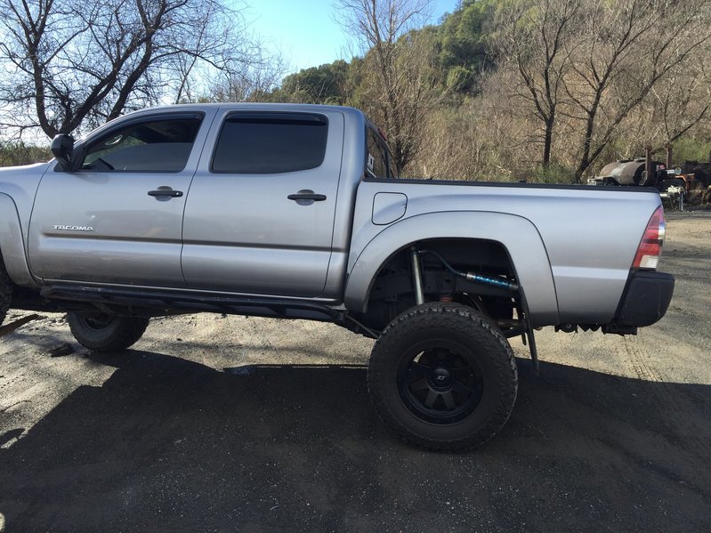

    This is AP Expos with 12" king and bamf shock relocate. Leafs are pretty new and still stiff. Probably get a little more flex once they break in a bit.image.jpg

    Do you use all of the 12 inches of shock?

    Some left. Have to measure. Will be good with the shackle flip o have to install
