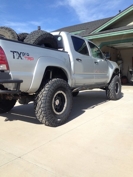

    33's? Nah, just stepped up to that 35" game. :D

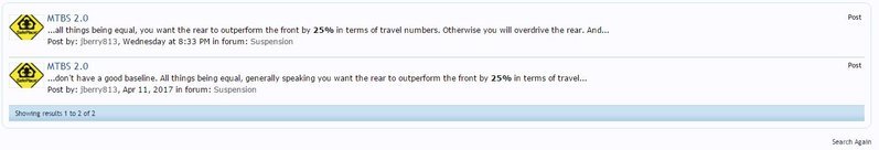

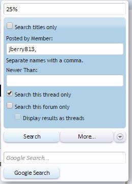

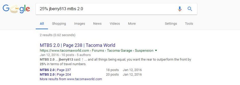

    I found it by searching this thread and posts from Jberry, or google would work too :p

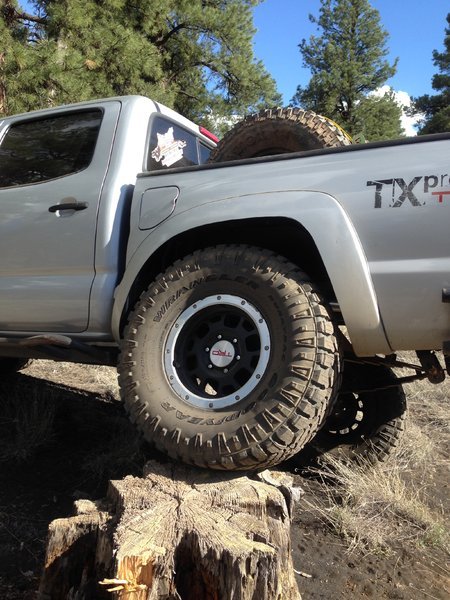

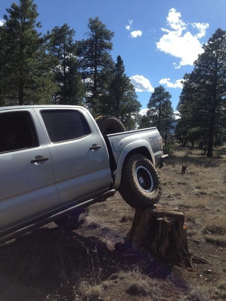

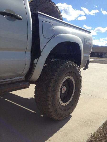

    Thanks
    Yeah already had glass up front. Though the front end doesnt even come close to clearing when stuffed. Trimmed up the rear in the mean time until I get rear glass so it clears.

    Thanks man. Yeah clearance is bad. Can't even run 33's without a decent amount of work to clear them fully. Then I decide to go 35's and unless I rip the firewall out I'm not making turns while articulated. Hoping to go LT soon and hope that'll help the front clear better.

    Yeah on my 33's I was able to do enough to only rub on my core supports at full bump.
    Gonna let the 35's do a little self-clearancing for now. I did a lot of work today to get them as good as they are.

    The plus side to LT is it pops the tire so much farther out you don't have to clearance for 35s AS much as stock length. Mainly pound the pinch weld back, and clearance the inner fenders. Firewall is a maybe.

    I'm running 2" spacers, so I stick out a little bit, but not LT. Pinch weld is back and I had my way with the mini sledge on the inner fenders. Should be ok for now other than getting close to bump but I'm just gonna let it rub and self clearance instead of limiting uptravel by spacing bumps. I'll just hope I can go proper LT sooner than later.

    Yeah but with spacers you're just increasing the turn radius of the tire, so in fact its going to rub more than stock, whereas with LT your pushing the turning point out so you wont be rubbing as much.
