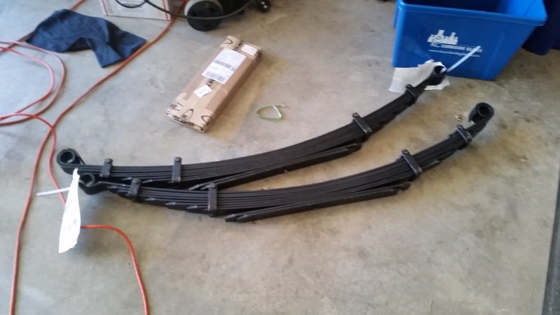

    I dont have everything yet but i got my leafpacks today from deaver

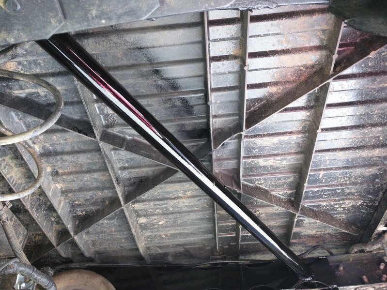

    There are some awesome space saver cages out there. The one @jeffz0rz did on @Evenflow linked rear is amazing. So clean and functional.

    Just checked it out and damn that's clean. I'm probably going to build a bed rack soon and may just build it into a bed cage and go ahead and shove some 14's in there

    Out of curiosity, any of you 2nd gen guys broken down an expo pack and measured actual travel?
    Are they really pulling around 12" of travel. Seems like if the shock is only limiting out on droop, it's more of a shock placement issue with the stock mounts.

    Yup

    Full droop the leaf pack is good for at least 2-3 more inches of downtravel than the shock allows, and at ride height I've got about 6inches, maybe more before I hit the bumpstops, along with the few inches the shock is already compressed. Next weekend I'll get my truck on stands and measure out for sure but I'm willing to bet the leaf packs will pull at least 12" of travel. Maybe a little bit more.
