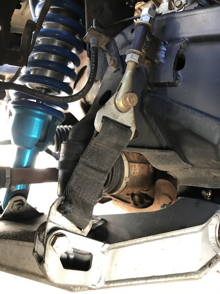

    Mine are 8" straps. That probably should be checked now that I see the fraying.

    Looks good...wish I didn't have these ugly fox's lol

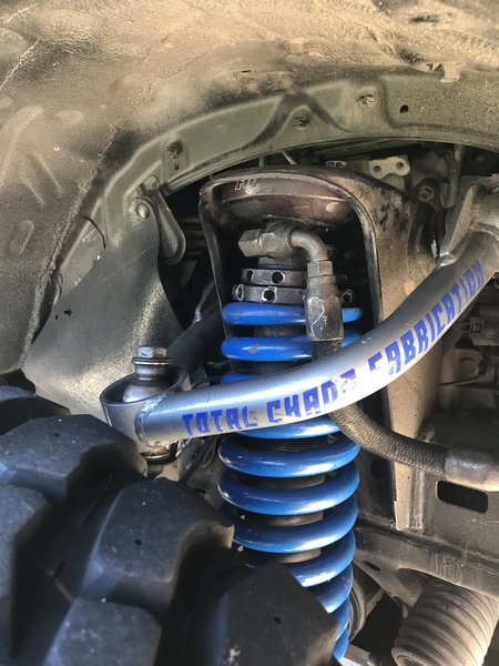

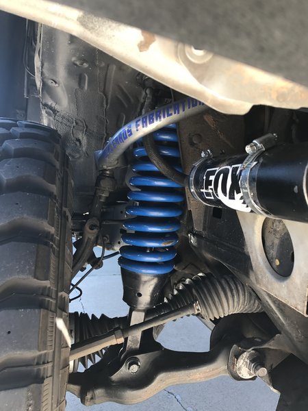

    Here's after I lowered the preload almost all the way...do you guys think the angles still look too much?IMG_4466.jpgIMG_4468.jpg

    Measure for coil bind and down travel.

    What do you mean measure for down travel? How do I measure for coil bind?

    If you lift the truck off he ground, how much more does the shock extend before the wheel starts to unload? That's your down travel.
    Coil bind: measure the diameter of the spring (a single coil) and multiply by he number of wraps on the spring. This is the shortest the spring can get, because the could will be touching. Figure out that distance between the spring seats (top and bottom) with the shock fully collapsed. If the second number is larger than the first you're ok. If it's not the spring coils touching each other will limit your up-travel on the suspension

    Maybe I'm confused but how does measuring the coil and multiplying by the number of coils determine the shortest the spring can get?

    Is this at full droop or ride height? I'm getting my truck aligned tomorrow and they're going to adjust the heims. I'll post a picture when it's done.

    That was ride heigh

    Mine looked like that, but with a bit more preload, to where my UCA was hitting the coil, and I was destroying boots. I just spun mine back about an inch of thread, and now I'm sitting about where you're at (UCA angle.)

    duuude...that's no bueno for it being at ride height - that means you have almost zero droop travel. Your outer CV boots look like they are dry humping each other too...
