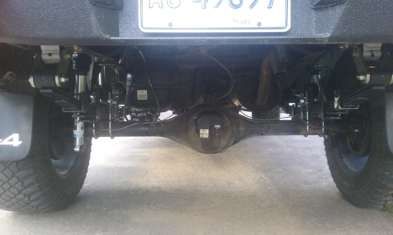

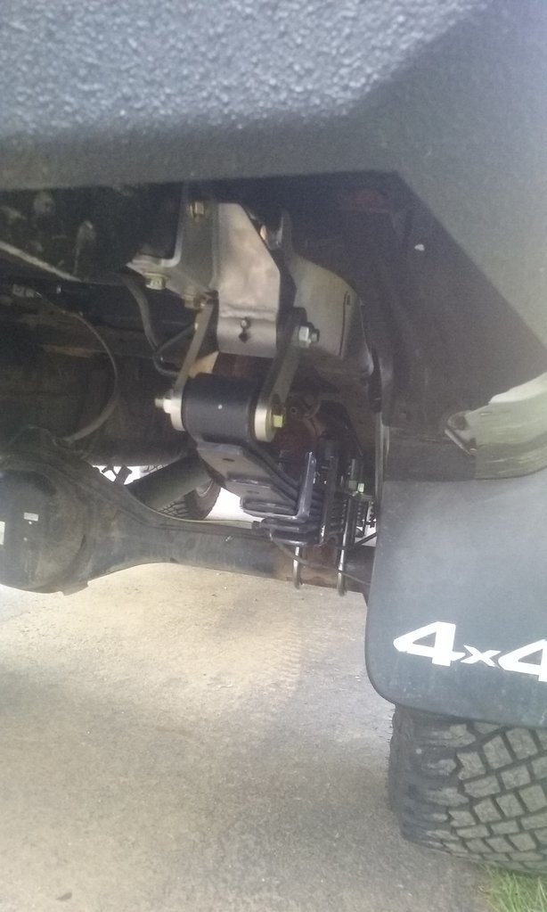

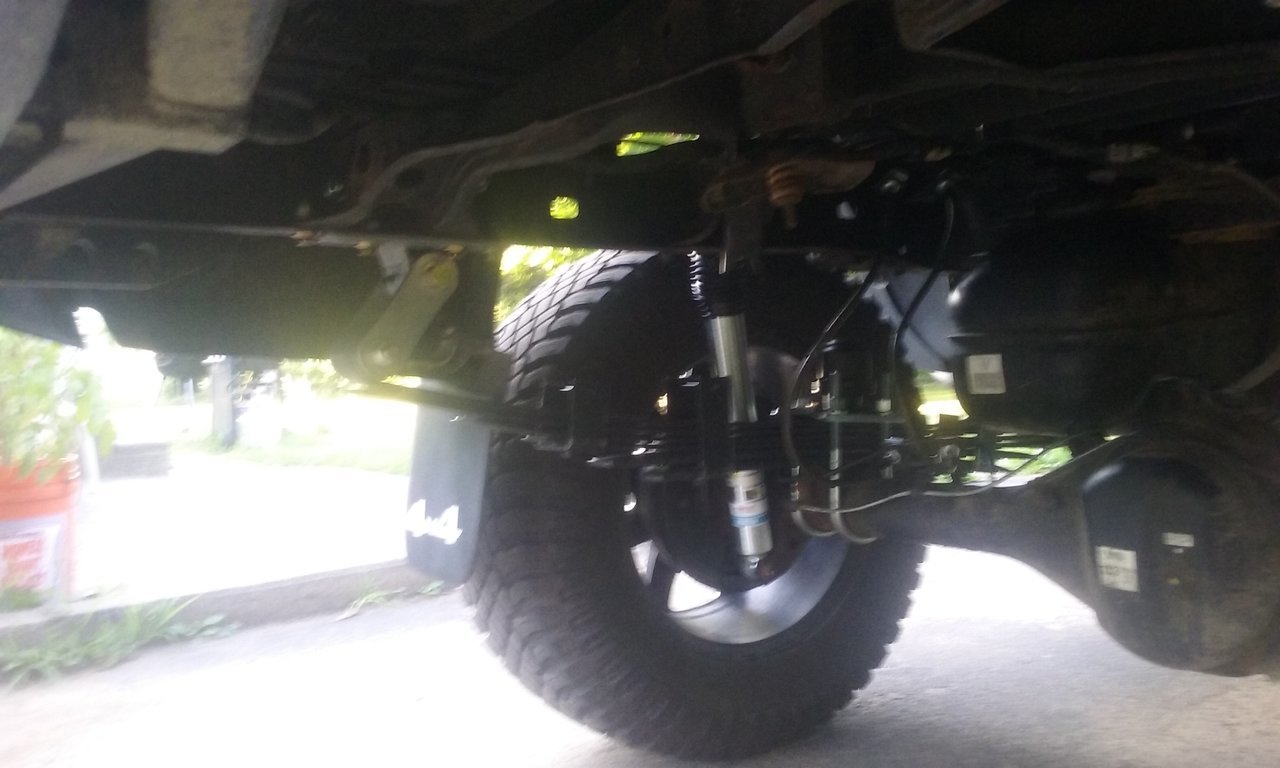

    Well got my rear suspension done this weekend @ARCHIVE garage shackle flip, OME Dakars, b110, u bolt flip and super bumps.
    ARCHIVE and jeff b like this.

    ya I always loved the look of the tacos with a shackle flip, something about seeing those beautiful stainless shackles hanging down. Did yours add any lift I can't tell on mine cause I had the TSB leafs with an aal so now I have an actual leaf pack that might be the lift I'm noticing

    Shocks don't add lift. So probably the shackle flip

    Both. My flip and Dakar's added almost 3-1/2".

    Yeah shackle flip, longer shackles and allpro standard pack get me about this.
    Inverted shackles (stock) shorter shackles add lift. With a shackle flip longer shackles add lift.
