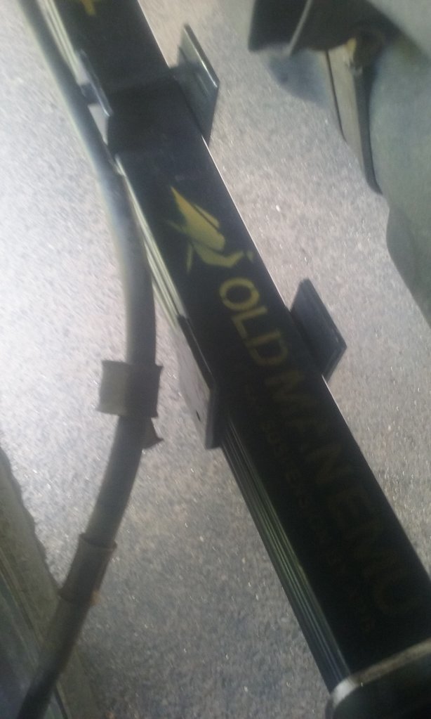

    Hey all so after my shackle flip I wasn't able to re-connect the E brake cable to the leaf pack is this normal? should I just cut the bracket off? It almost looks like when flexing if it were connected it would cause issues???? Can someone smarter than me help here hahaha

    I just slid that little tab further down and attached it where it would go without binding the cable.

    I just cut that bracket off the E-brake cable and have had no issues so far.

    I just bent the bracket away from the spring a bit.

    I tried bending the bracket and tried using zip ties but after them continuing to break and fallnoff I just ended up cutting that bracket off. Haven't had any issues

    Awesome thanks guys that's what I figured as well..... She's got a date with the cut off wheel :sawzall:
