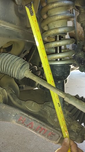

    6'', 8'', and 9'' straps being used with stock length arms. I'm planning on running an adjustable clevis and running it to the lower shock bolt. Can anyone help me figure out what length I should get? Or should I just be different and go with a 7'' :)

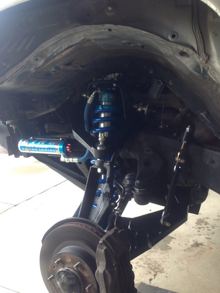

    I like the adjustable clevisb so I'd droop out your truck and measure from wherever you are going to bolt it to your lca to somewhere on your frame. I'm LT with 8" straps. IMG_0677.jpg

    I'd say any of those lengths will work using an adjustable clevis and the shock bolt, just a question of how high up the frame you have to weld the clevis mount.
    Based on my experience, I'd go shorter than longer, because I was running out of frame to weld to, and have the clevis cranked down quite a bit.

    It turns out, actually taking a measurement really helps. Who would have thought?? :rolleyes: haha.
    TBH, I wasn't near my truck and was hoping someone had a rough measurement so I could just order the parts. :D This is what happens when I get bored and am in work meetings all day..... :anonymous:
