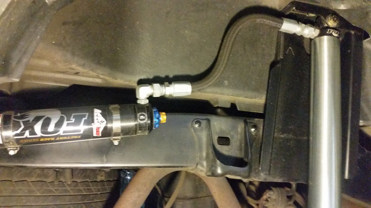

    Getting there

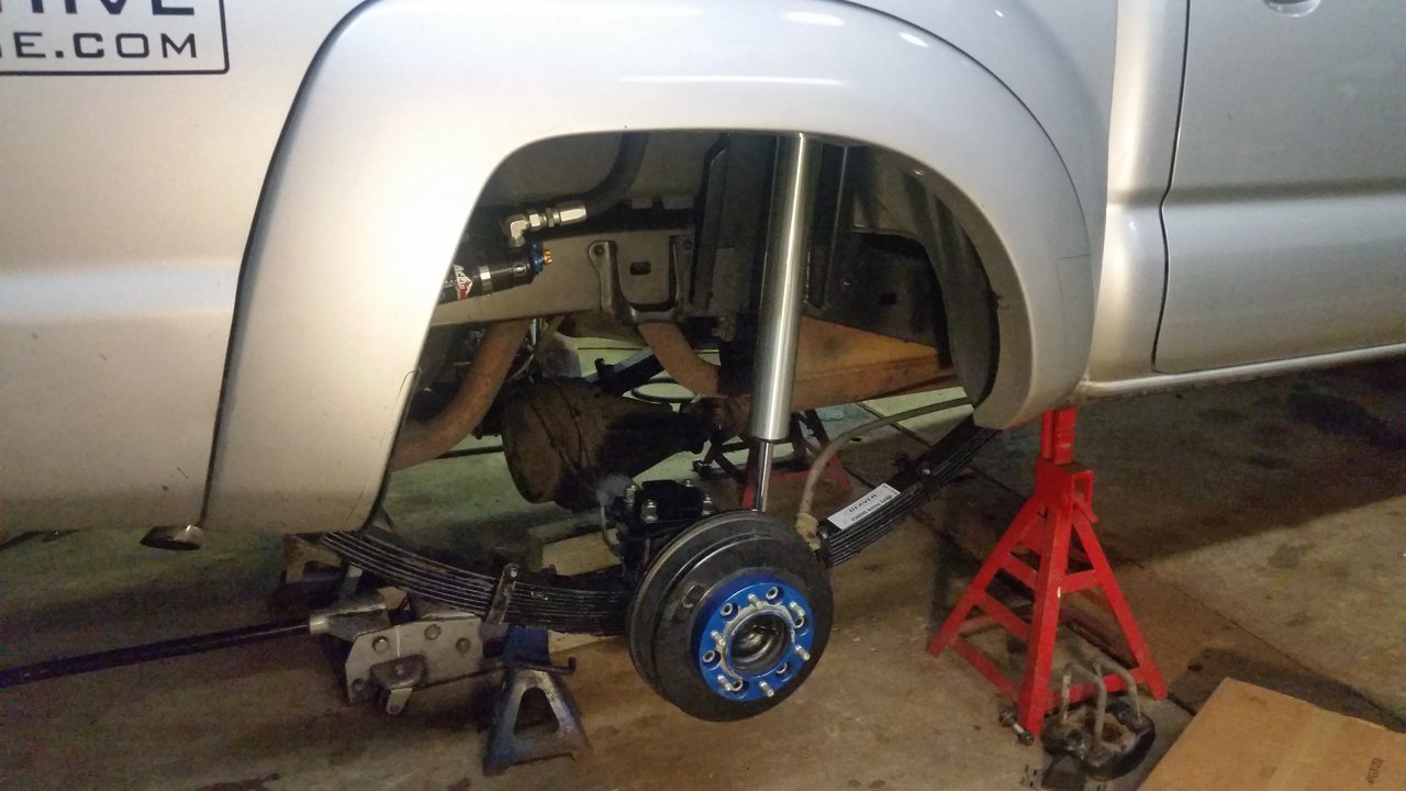

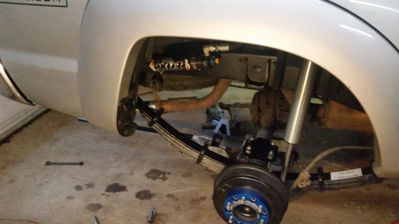

    2.5" Fox relocation * Hammer hanger * Archive MD springs
    New Hammer hangers and 4.9" shackles installed with spring under conversion

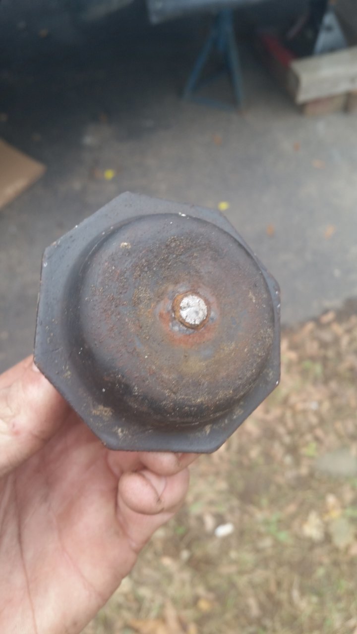

    Hey guys so I was trying to remove my stock front bumps stops and of course I snapped the bolt. Any ideas for a remedy please help hahaha.

    Maybe a bolt extractor bit but I don't think that will work if it's that badly seized. Probably have to just drill it out and retap the thread. Did you use any pb blaster or something like that before trying to loosen the bump?

    I hit it last night when I did the coilovers and UCA'S and totally forgot to re hit it this morning
