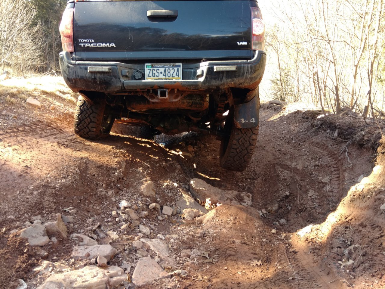

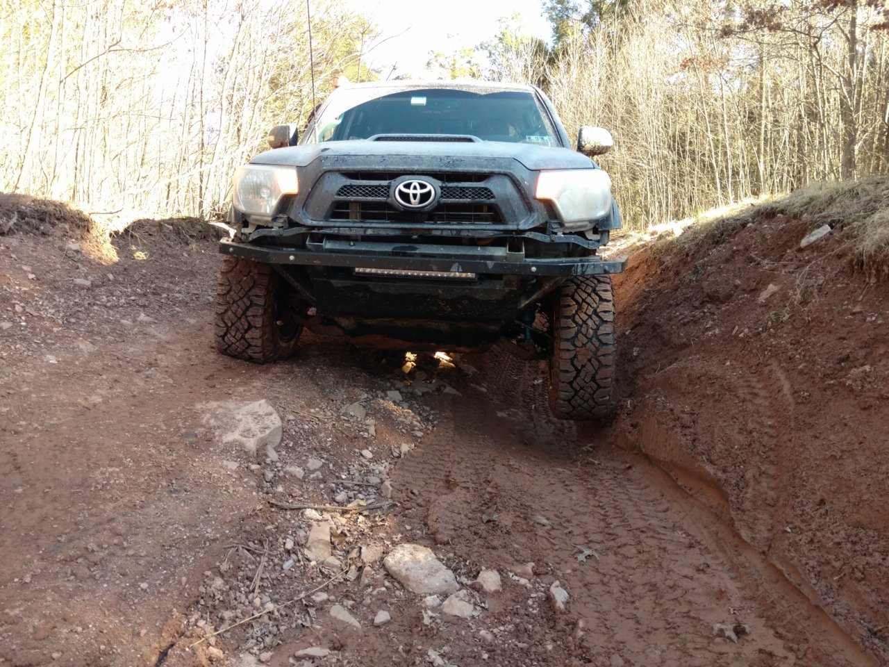

    My observation: Increased travel in the rear allows the truck to stay close to level longer, and therefor stuff the front tires further due to increased weight on that corner. Instead of the whole truck tipping. See picture below. This is low speed crawling, btw.
    Regardless of the dynamics that achieved it, on my last trip out I definitely stuffed the fronts farther than before, as measured by getting the tires to rub on the fender flare, and the bump stop hitting the LCA. I confirmed the shock is not bottoming out, but I'm not sure how much of the bump stop i actually used.

    it's entirely possible i'm thinking about the dynamics of this situation wrong....

    Got it, you are using more of the travel, but the travel did not change.
    Yup.

    yes, i'm actually using the travel it's capable of.
