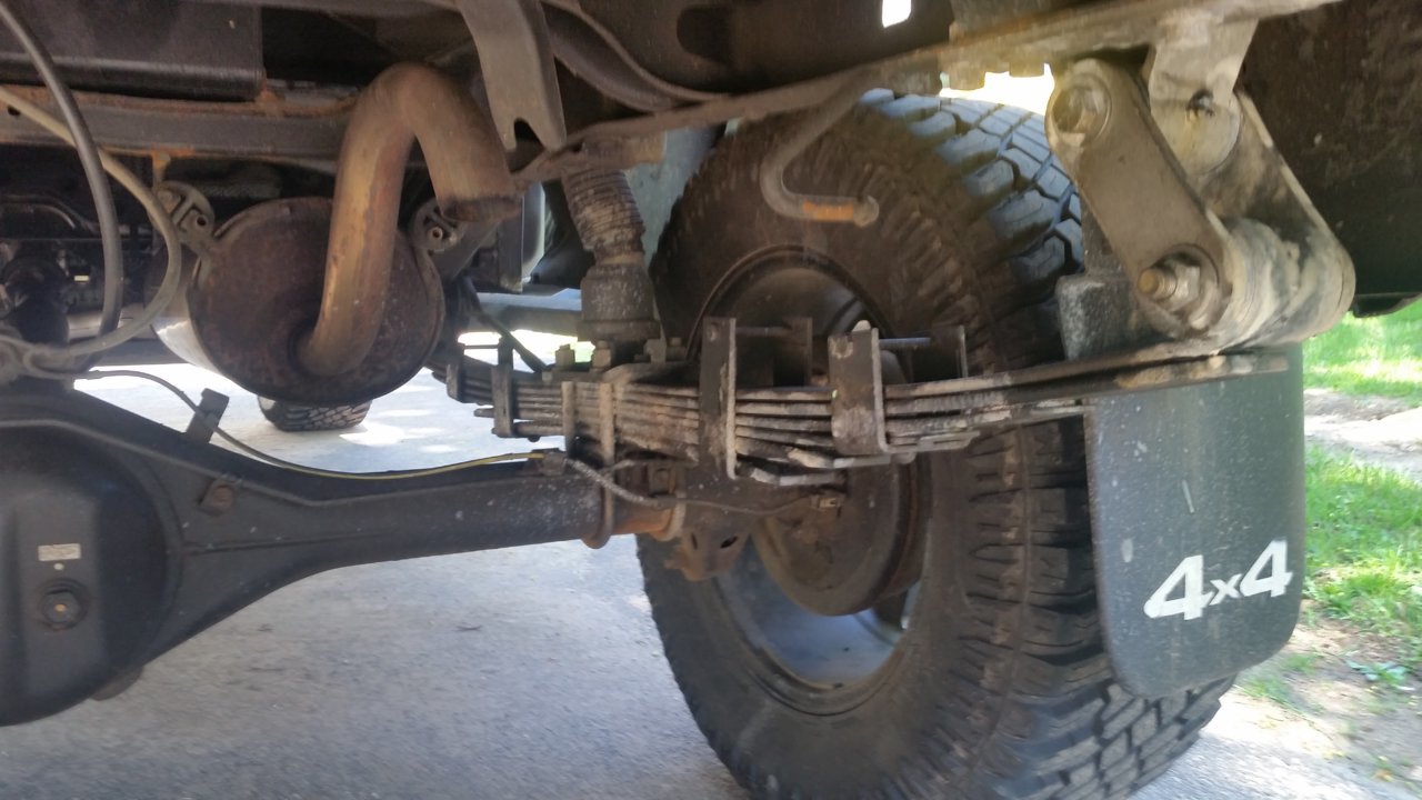

    No bolts are in that location on my Dakars. Did you verify everything is torqued? Also check carrier bearing..There is a possibility it is spring slap from axle wrap, but doubtful.

    Ya I double checked like a month or so ago and everything was still tight but I'll definitely check again. I did the rear suspension almost a year ago and as far as I can remember it always made the noise. It does when flexed and just normal driving, I admit I don't know a whole bunch about suspension but I'm pretty sure those leafs being almost straight like little to no arch is definitely not desirable? Right ? I think anyway

    Every set of Dakars I have seen are flat, both with flip kits and with stock hangers. Look at the bottom overload. It is already in a negative arch, which essentially means that the spring is designed to go into negative arch when heavily loaded.
    I would definitely check everything back there as a clunk is not normal. Squeaks yes, they are Dakars after all.

    I wouldn't limit the search to just the rear end either, clunks can sound like they come from different places than the actual issue.
