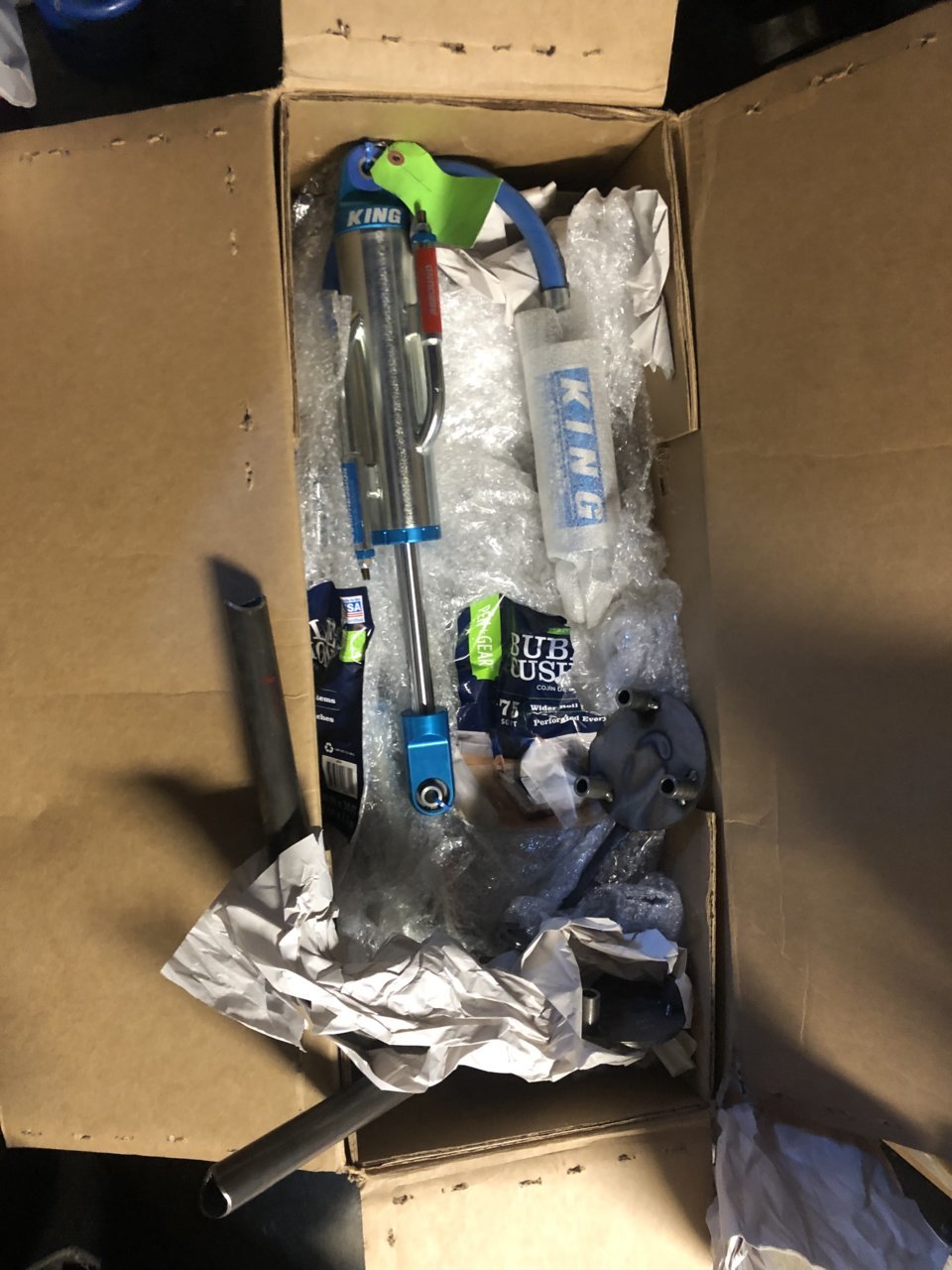

    Got some super bumps and King 2x2" ordered. Thanks for the help. Now just need to wait and get all this shit installed.

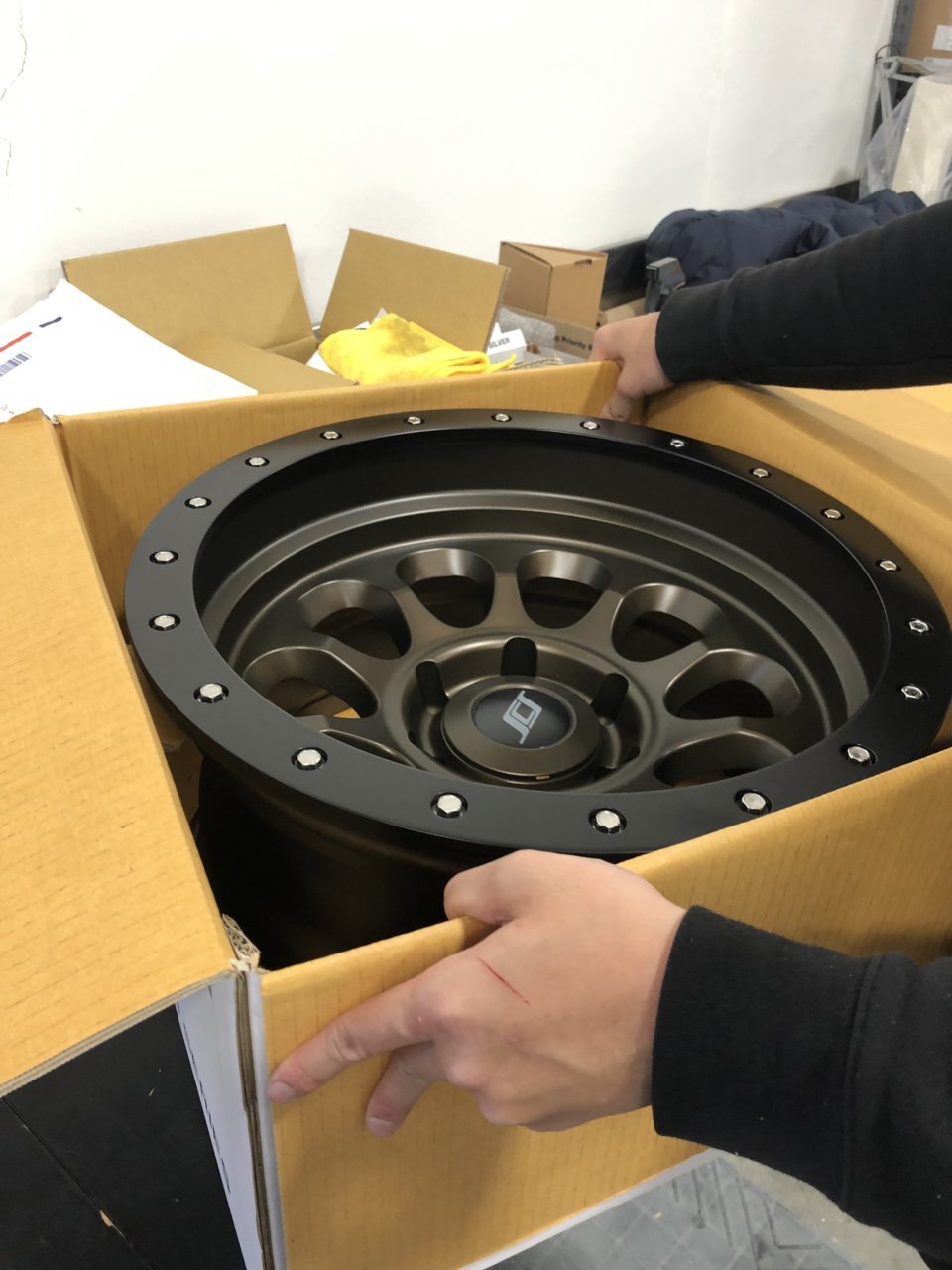

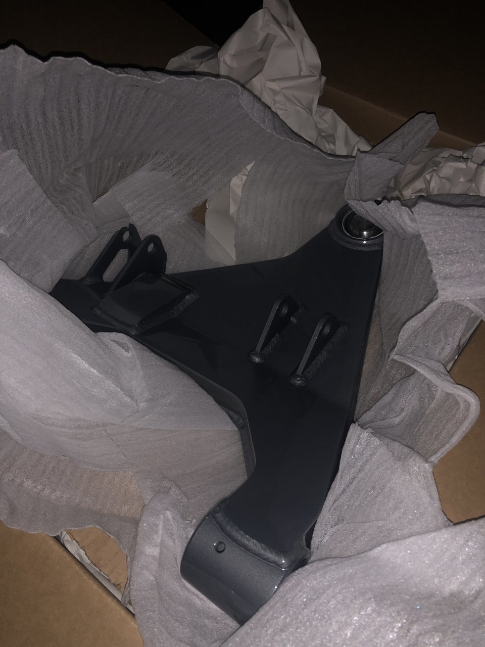

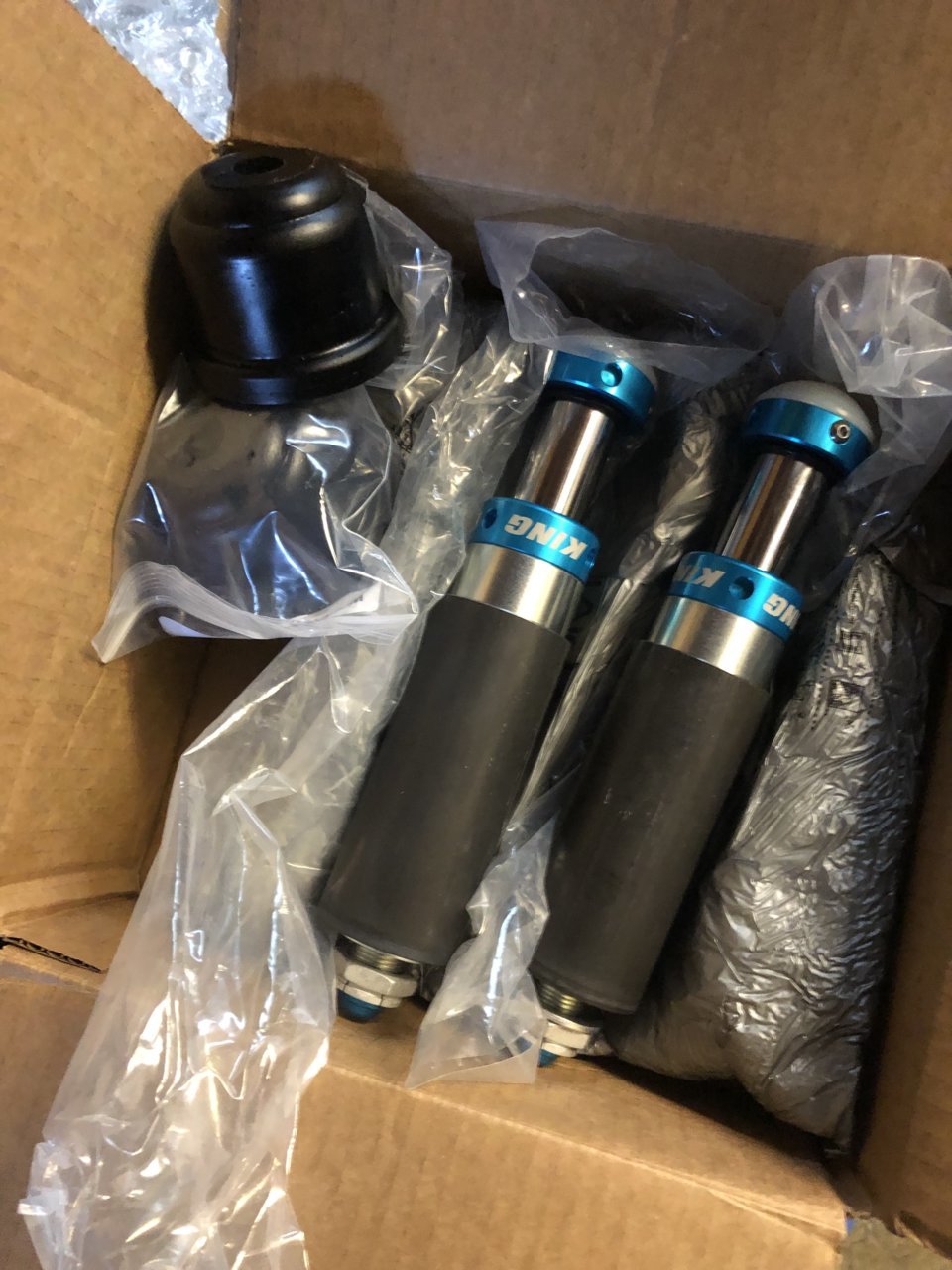

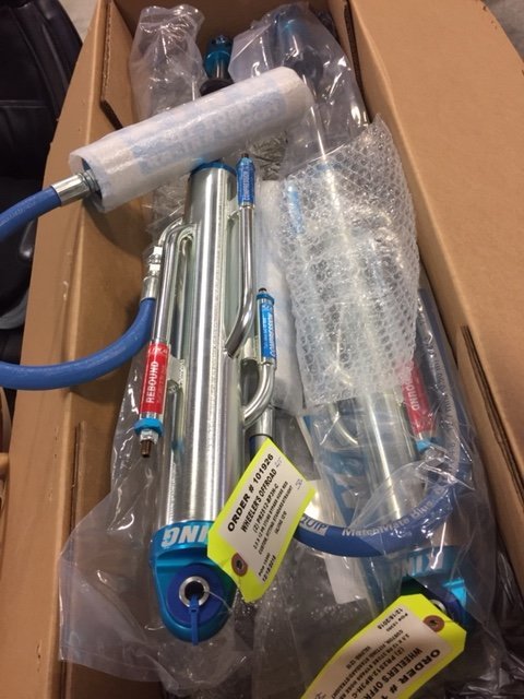

    Excited, most of the MT goodies have arrived! Some much needed Fab work is in order. Thanks for the rec on bumps. Went with super bumps for the front and 2x2" for the rear. Just need a new leaf pack now. Currently running King 2.5 Ext fronts and 2.5 rear with a full dakar pack with extra leaf (need to change this up).
    Picked up the new Ray10 3.5BS and won't need to run spacers for the Front Race lower or relocate (hopefully)
    Taco-Obsessed and Glueman like this.

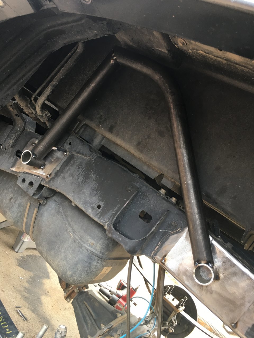

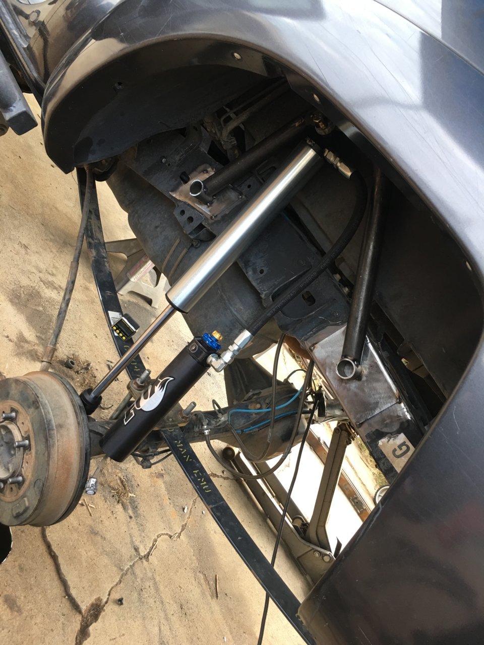

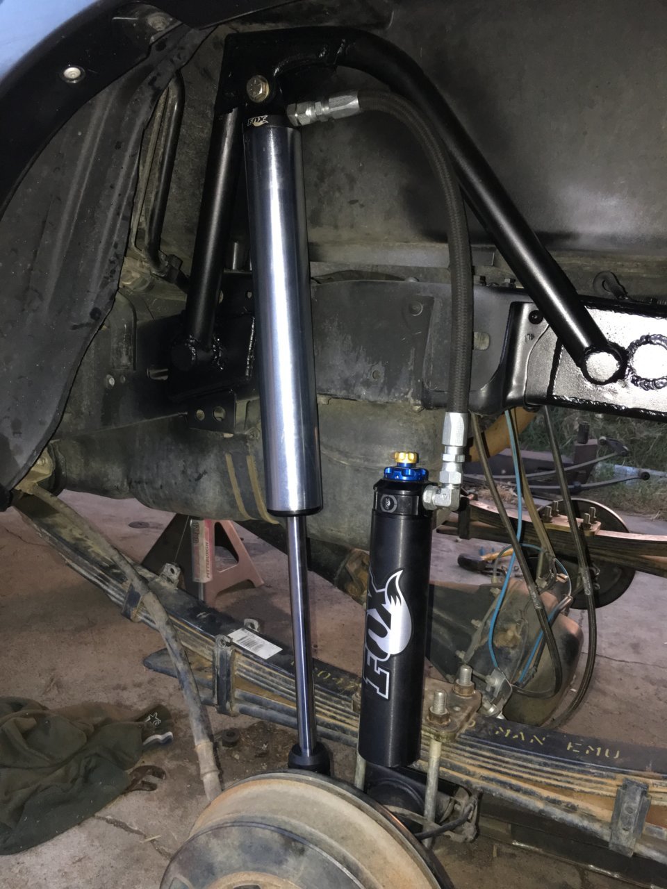

    May as well share this in here. I had a hard time finding info on how people were running their rear limit straps so I kinda did my own thing and I'm very happy with it. 2" square tubing, .120 wall, and the sides are 1/4" plate. Welded the bar together off the truck so I could get paint everywhere that needed it. Used TMR customs upper mounts (they're SOLID) and 14" trail gear straps. They're 6 ply vs all others I found are 4 ply. I like how beefy they are.
    All of this is for Dakars, hammer hangers with stock shackles with poly bushings, and 12" 2.0 king smoothies in a BAMF mount.
    Running this for a few months and it's rock solid.
