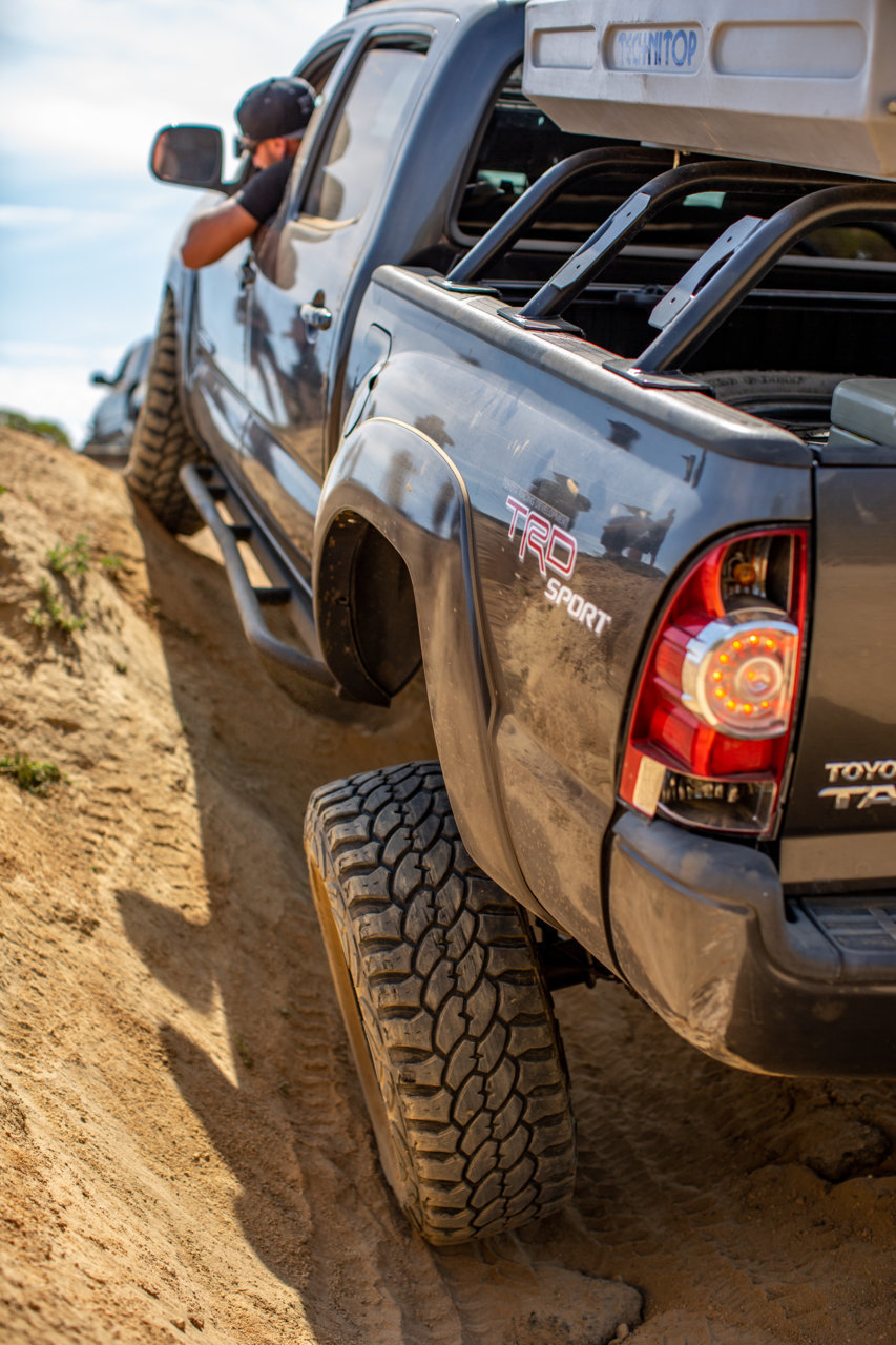

    Because I also found this pic and why not.
