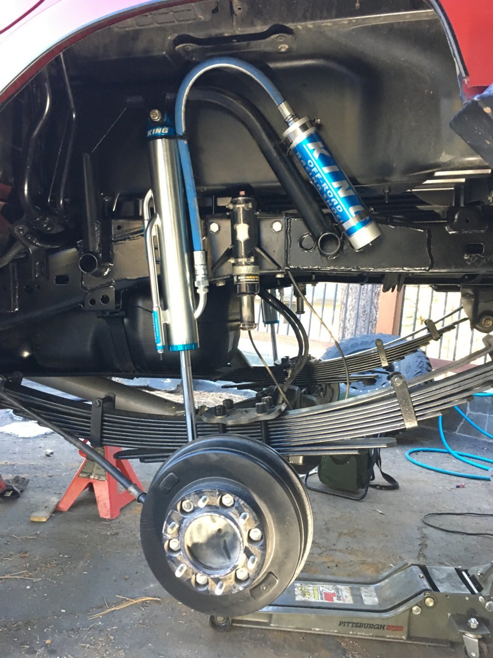

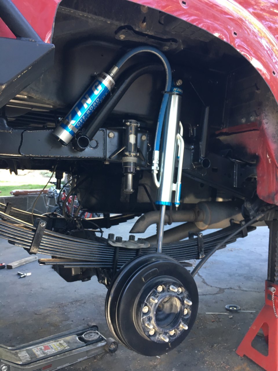

    0CEF4DF7-99E0-4EE8-9D66-BD583EF4B37E.jpg FAAB3AA4-6992-4A99-B796-4A853DF7DBFC.jpg 9408FF38-6EBC-4EAE-8265-69CFE9F9F859.jpg 8615AFE6-9C89-4213-A18E-2CB8E2E12C48.jpg 76691E9F-A133-4AB6-8417-DCE396745ADF.jpg

    You’ve got more leafs in that pack than a national forest. Looks good.

    That’s what I wanted. It’s a custom Deaver pack built to my specs. Lots of thinner leafs to be flexy and still built to handle payload of 1300 pounds over stock.

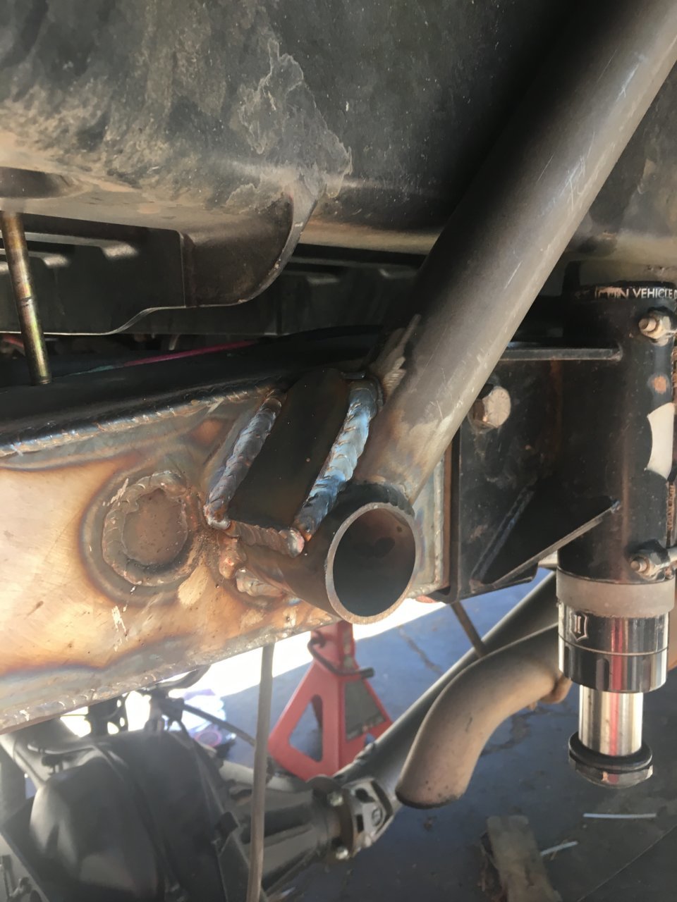

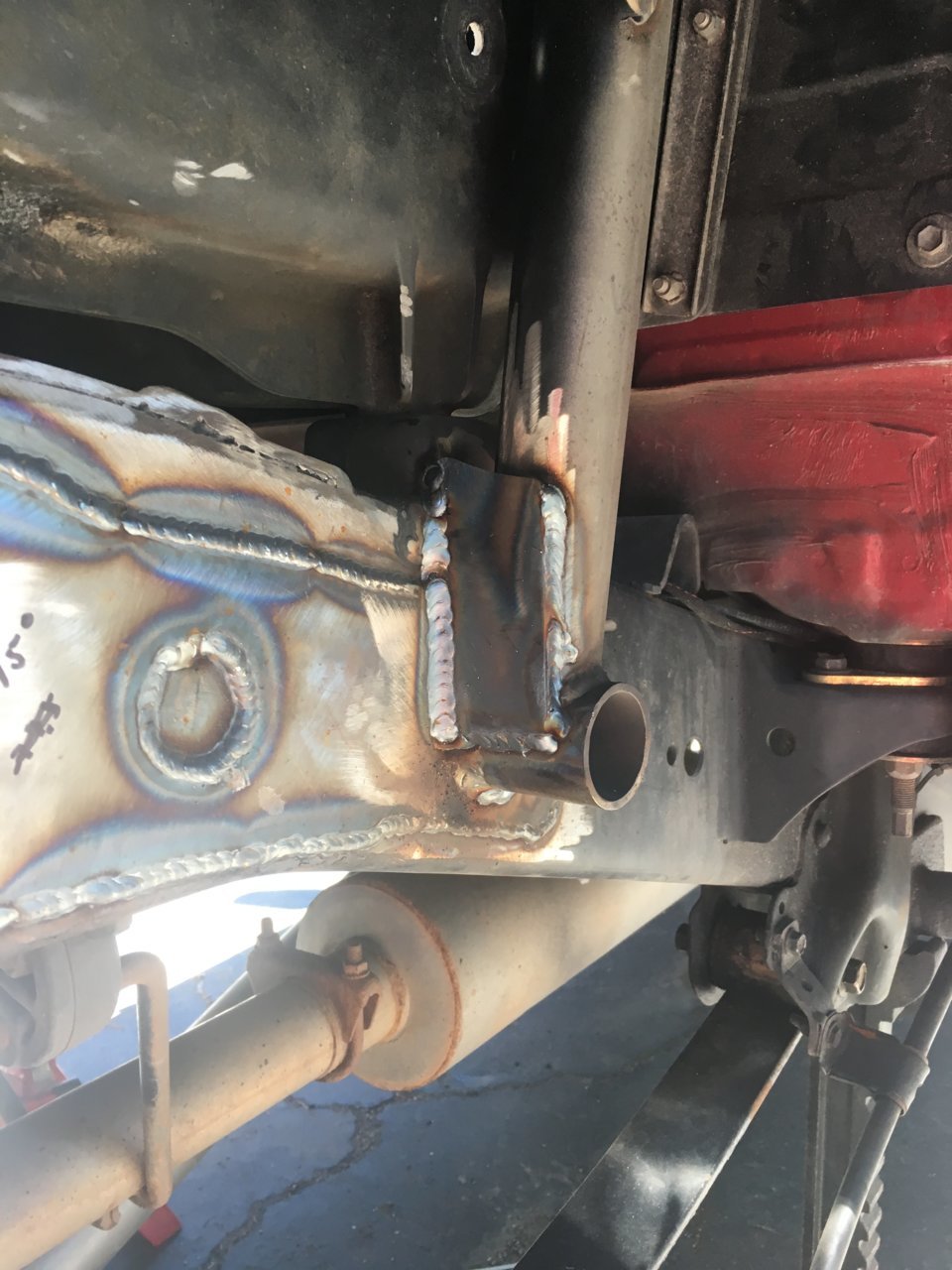

    Are the two gussets the only two you utilized? Originally, I didn't have any but I threw a GoPro on the frame and watched my hoops flex under load so I added two per hoop. Still need to setup the camera again and see if it helped.

    Ya there is the two gussets on the frame. I have a top plate I was going to weld to the top of the hoop and sammich the bed with another top plate and run a crossover tube between the two hoops...but it hasn’t happened yet.

    Before and after rear shock hoops shots.
