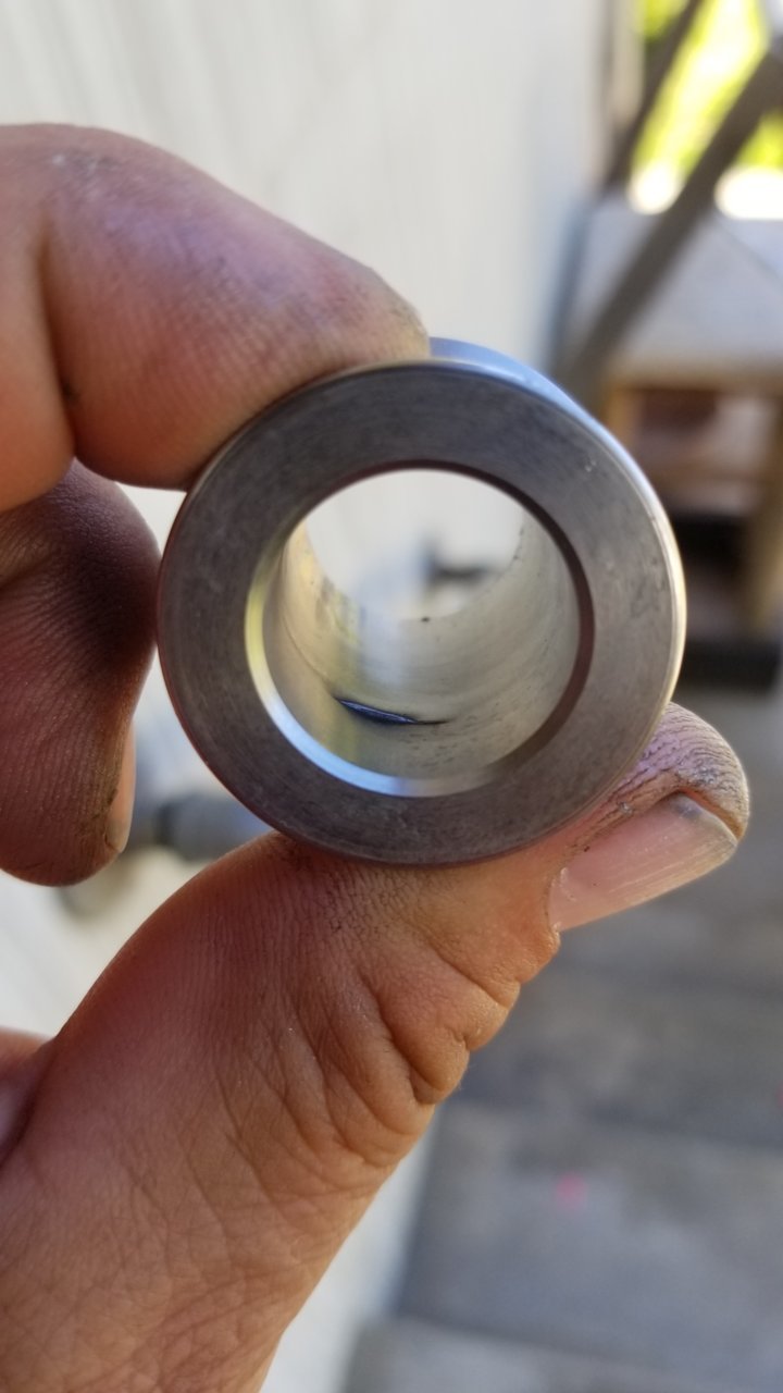

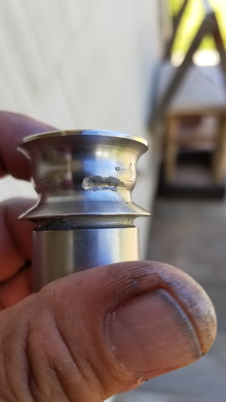

    Crushed spacers, blown lbj's, dirt exploding impacts while skipping off skid plates ,bypasses look awesome, removed sway bar......midtravel madness :transformer: 20190906_163412.jpg 20190906_163407.jpg
