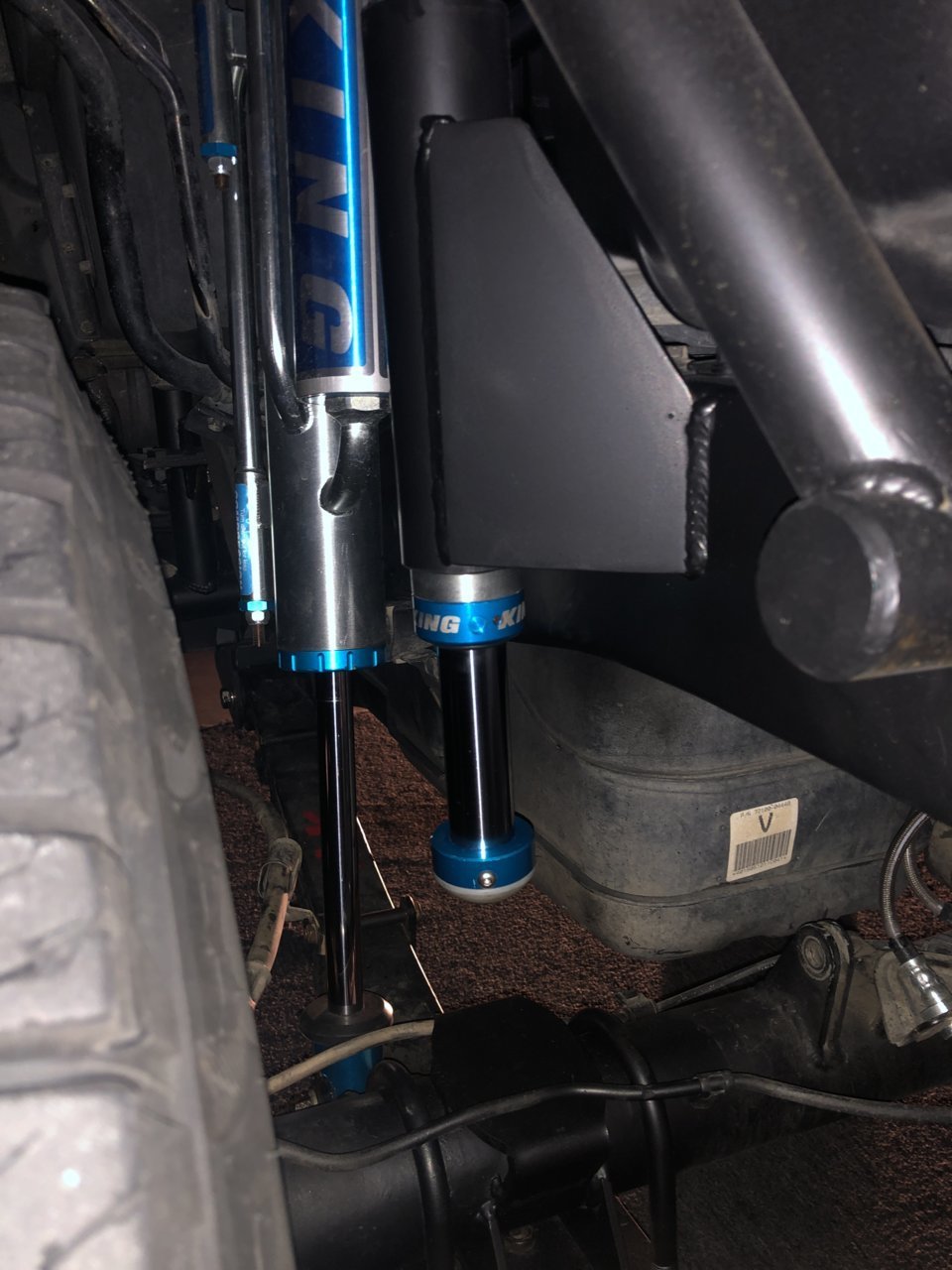

    ended up with a custom job. I was going to have @desertjunkie760 set me up. If your local got him up great work. but couldn’t find time to make it to SD. Had a local guy fab it up. Milo at Milogen in the Bay. Still need to get a cross bar but was in a hurry for a trip last year. Limit straps as well.

    I went with 12” setup. after seeing yours made me really wish I had gone 14”-16 especially hearing how well it’s ran for you. I went 12” due to similar points @desertjunkie760 noted before on up travel. I got a killer deal on the front bypasses which is which is why I did it. Revalved the front to compliment the bypasses but had some clearance issues. Knocked one of the adjustment knobs of the bypass off so need to rebuilt the bypass tube. should have been fine running the SCS -38 but needs 1/2” or so to fully clear.

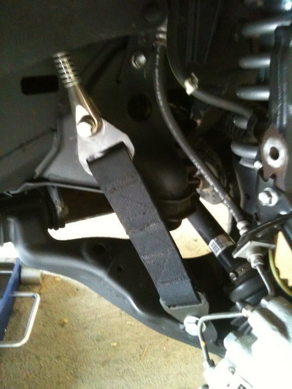

    Hoping some of you gurus can give some advice on limit straps for the front, when using stock LCA. I'm not asking for a discussion of the merits or mishaps of stock LCA. But rather, where did you mount the lower double shear tabs (can it be on the bumpstop pad and still clear a super bump/mount, or use front side of shock bolt??), where did you put the upper adjustable clevis on the frame, and what length straps? Did you observe any problems with the setup after being run? I am looking at all the parts at Kartek, but particularly interested in where the tabs are welded, what length strap, and do you have any issues with the strap rubbing anything at compression (it does have to bend to allow compression), I wouldn't want it rubbing shock, bumpstop mount, or if on the front side, the tie rod. Hoping to know what I order will work, rather than getting something in hand to mock up just to realize I need something else.
    Pics would be great! I haven't read this entire thread, and there are thousands of mentions of "limit strap" in the search of thread that don't apply. Hoping to get some real world input and/or pics from those who have done it already, so I don't reinvent the wheel.
    Current setup on my very heavy expedition rig: ARB front diff, stock LCA, whiteline bushings, wheel moved forward via new LCA tabs, SPC UCA, superbumps, BP-51 shocks with top plate spacers to make them 'longer' (yes I checked up travel). I am fitting/trimming for 35s, and wanting to reduce some of the rebound damping on the shock, but doing so gives terrible top out clunk, plus looking to limit full blown max droop to save CVs (since shock is actually longer and travel is moved more in the downward range).

    I found this pic. I need to add limit straps as well to stock lowers.

    Looking through more images most seem to go in front of the CO. I found this one too

    I like the look of that honestly. doesn't look too much like the lower tab is bent outward (a non aligned force isn't good), doesn't look like the strap is contacting too much on the tie rod (but who knows how many miles and or good compression wheeling moments were on that setup at the time of picture). Also looks like the upper mount is on a very strong portion of the frame, not just the middle of the frame rail. But the best part of it is that you are stopping the shock where the shock exerts force. Rather than at some other place that would place a cantilevered force on the control arm when the strap is taught.

    My thoughts exactly. That portion of the LCA is already designed for all that force. I'm going to do it this way and see how it works out.
