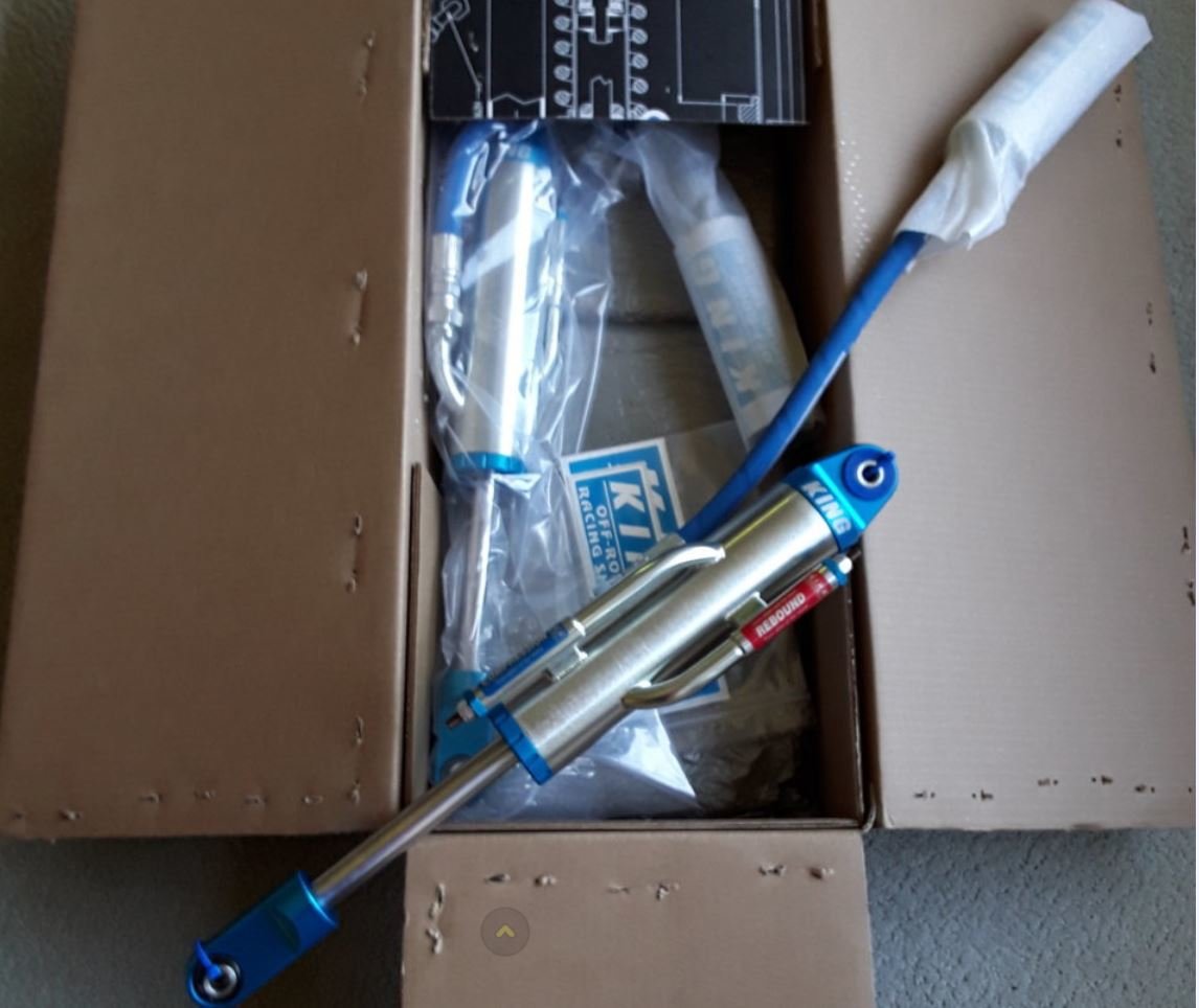

    Does anyone have dual shock mid travel? Care to share info about the secondary shock? I will be doing this next year probably.

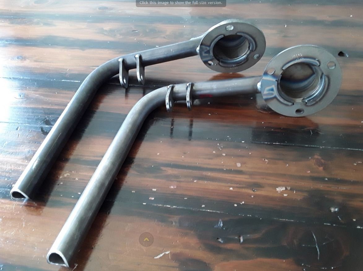

    I am working on mine right now. Going to weld up dual towers from TC next week.let me dig up the # of the dual bypass I am using.

  9. Jun 3, 2020 at 6:54 AM
    #5489
    Micatom33
    Micatom33 Under the Truck with Beer!
    Jul 17, 2013
    #108443
    1,673
    Santa Cruz,CA
    2008 BSP DCSB
  10. Jun 3, 2020 at 6:55 AM
    #5490
    Micatom33
    Jul 17, 2013
    #108443
    1,673
    Santa Cruz,CA
    2008 BSP DCSB
    connecting these to TC EXpO stock width lower control arms

    Thank you. I have some PMs out to a couple vendors. I wasnt sure about triple or dual bypass shocks. I also think that the prices listed on most sites are for each, and not for a pair? aka ~$785 that I saw somewhere..

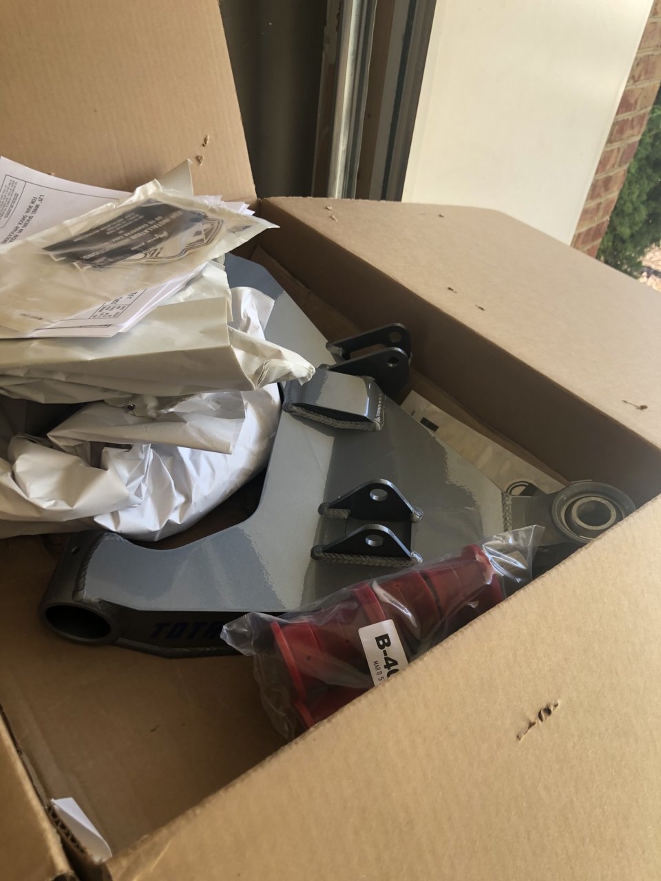

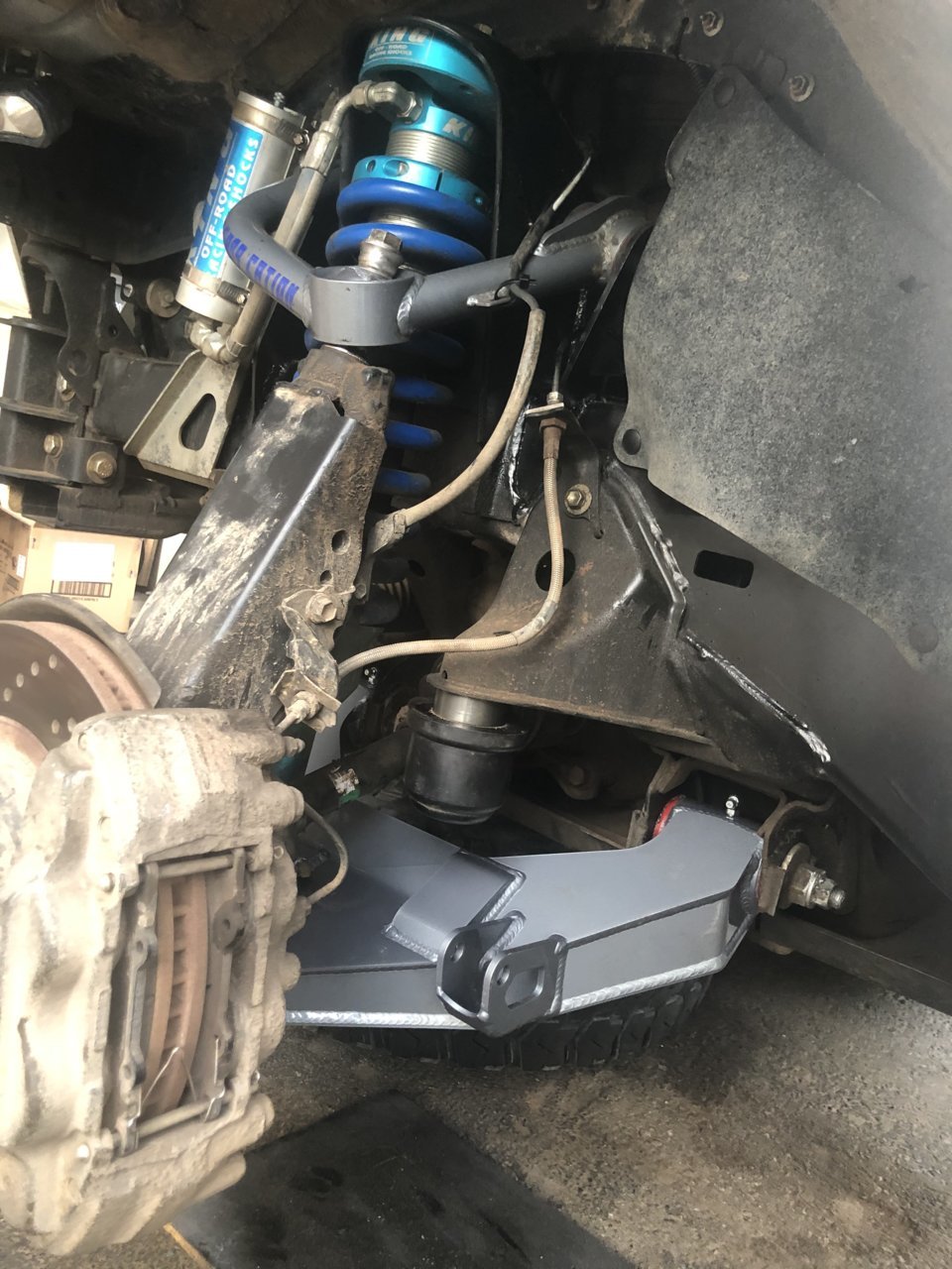

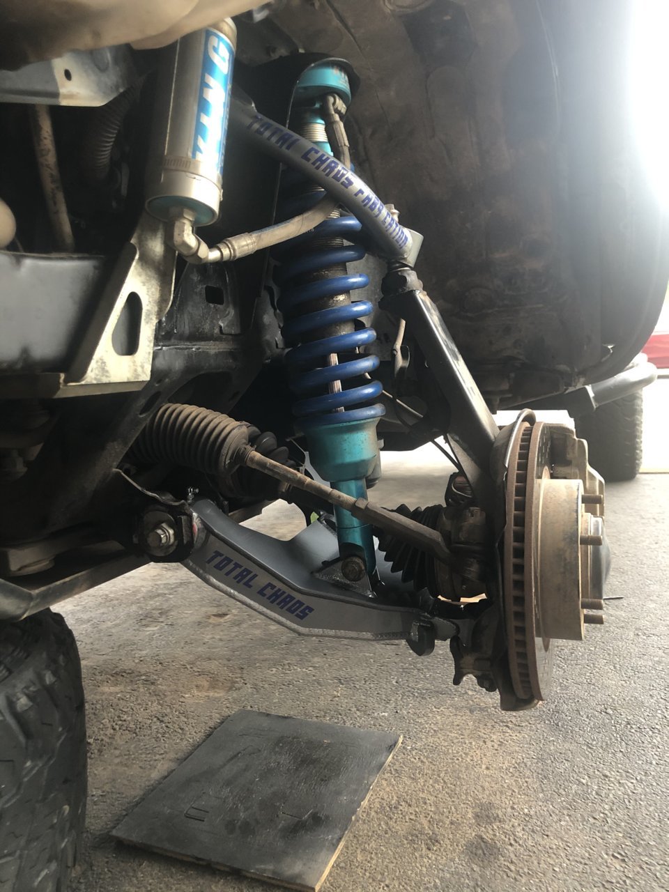

  15. Jun 3, 2020 at 4:55 PM

  16. Jun 3, 2020 at 5:09 PM
    #5496
    Arcticelf
    Arcticelf Well-Known Member
    Jul 18, 2015
    #159735
    7,662
    Gladiator
    Welcome to real control arms :) and more travel.

  19. Jun 3, 2020 at 6:14 PM
    #5499
    Micatom33
    Jul 17, 2013
    #108443
    1,673
    Santa Cruz,CA
    2008 BSP DCSB
    These 8 inch straps are part of my plan. Thinking in the front.
  20. Jun 3, 2020 at 6:18 PM
    #5500
    Micatom33
    Jul 17, 2013
    #108443
    1,673
    Santa Cruz,CA
    2008 BSP DCSB
    Looks great. JSYK You need to get some paint or sealer on that spacer as it will rust.
