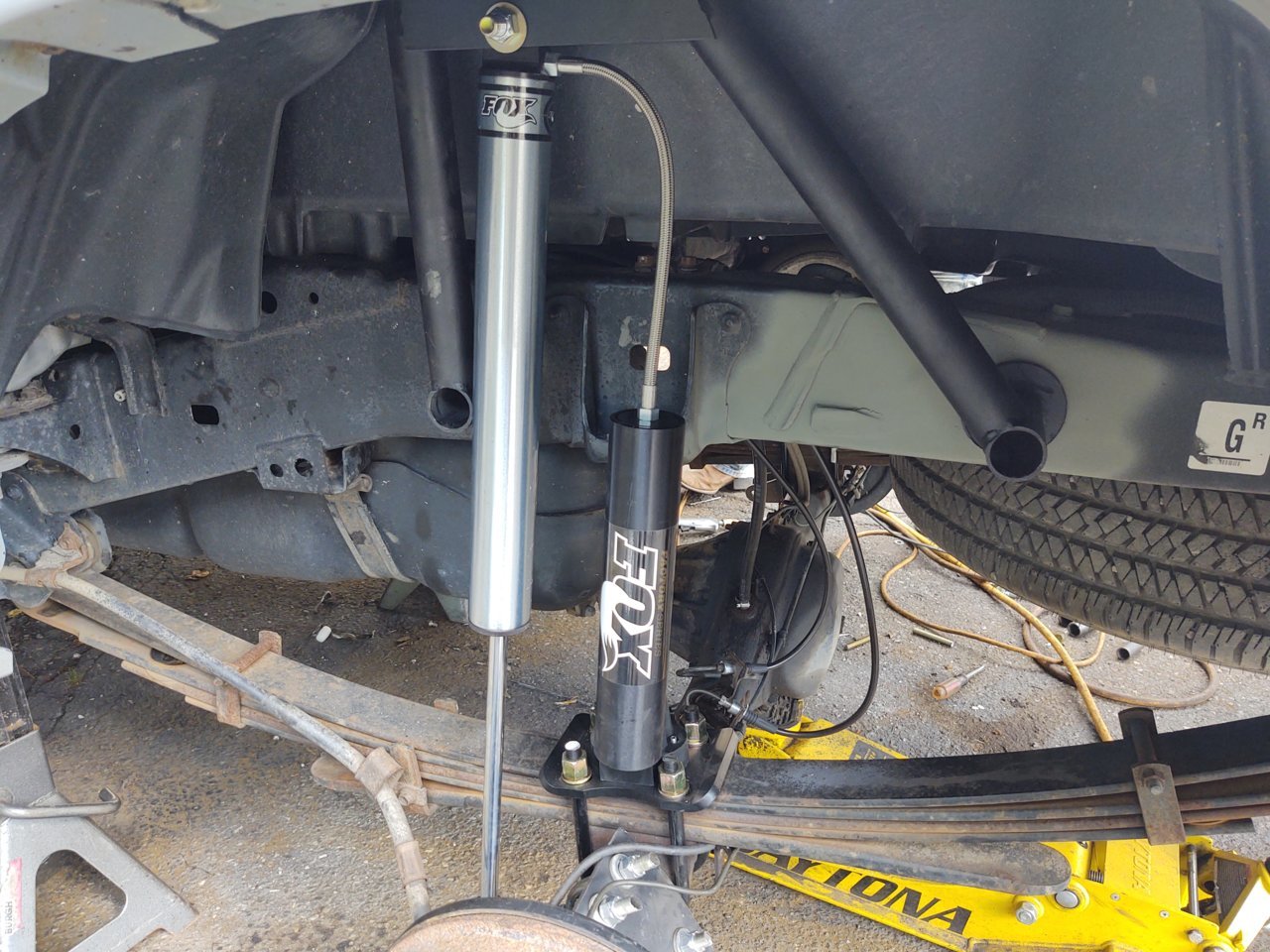

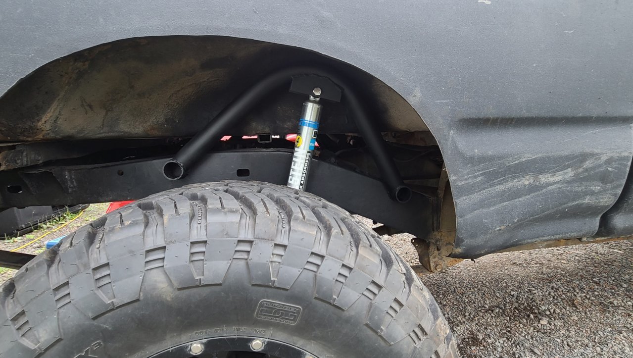

    I've been working on a 100% bolt on solution for that. 12" king or fox shock, you do have to cut off the old shock mounts on the frame and axle to install the new parts. @TwistedTLM4 has my prototype on his truck.

  6. Sep 4, 2020 at 5:07 PM
    #5566
    Arcticelf
    Arcticelf Well-Known Member
    Jul 18, 2015
    #159735
    7,662
    Gladiator
    Here's the install.
    I need to update the axle bracket, and get a couple sets welded up, but I should be able to get you one in early to mid October. That will give you some time to find a good deal on a shock set too.

    Why do you have the resi mounted to the spring perch like that? Won’t it hit the frame at bump?

  9. Sep 4, 2020 at 5:18 PM

    its just hanging. not mounted

    Run the wheels outboard? Like wheel spacers? Shouldn’t for this setup

    Where does it mount to and when do you think they'd be ready for market? I plan on doing a relocation prolly within the next year and would love to not have to spend money to have someone weld one on

    It's just hanging. Depending on hose length the resi can go on the inside of the hoop or under the bed.

    This fall/winter, I need to build a second round of prototypes and then out them into production. The hoops bolt to the frame, and the shock mount bolts to the axle.
