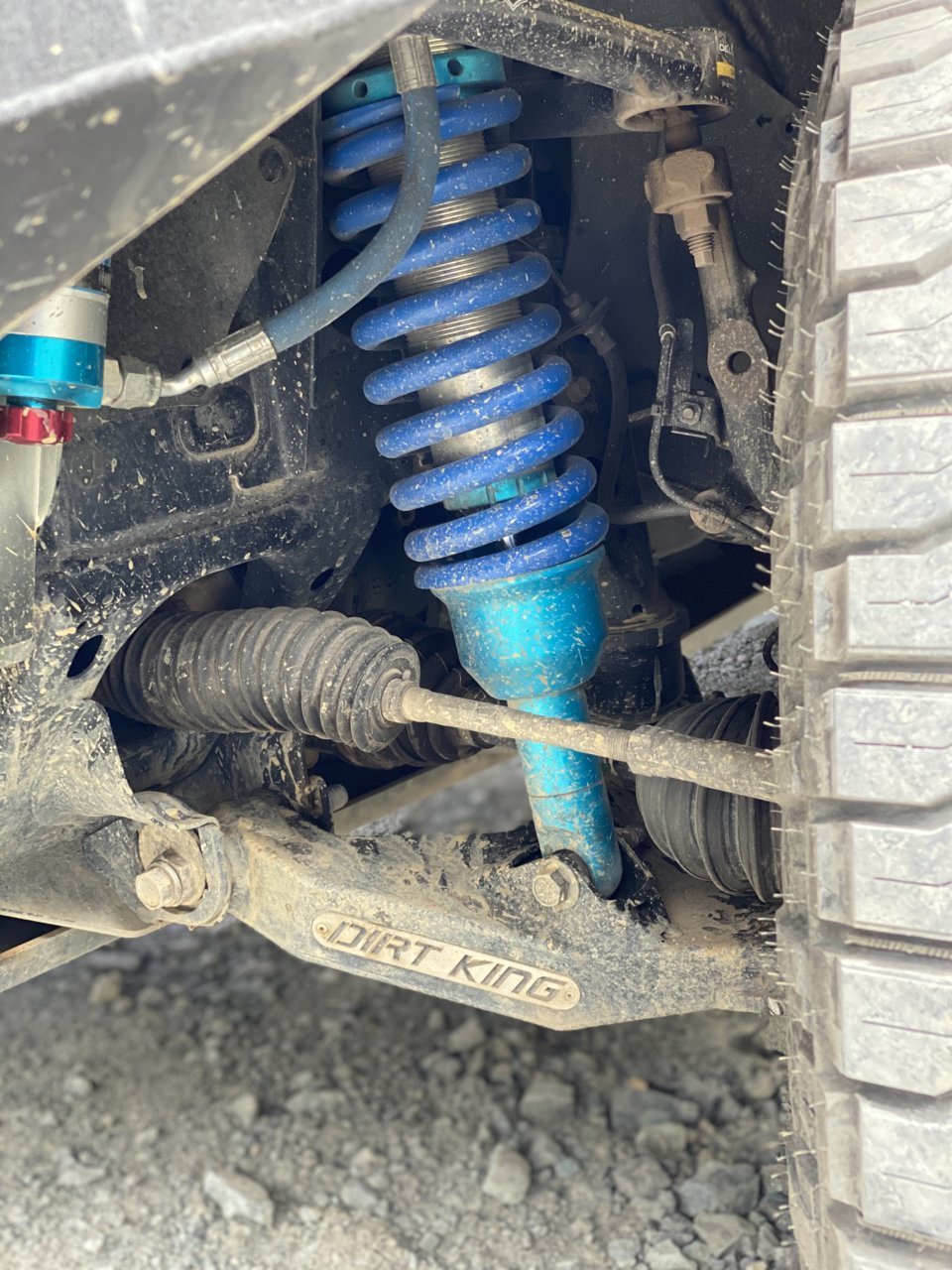

    I was considering placing mine in the same location but was concerned about it making contact with the tie rod.

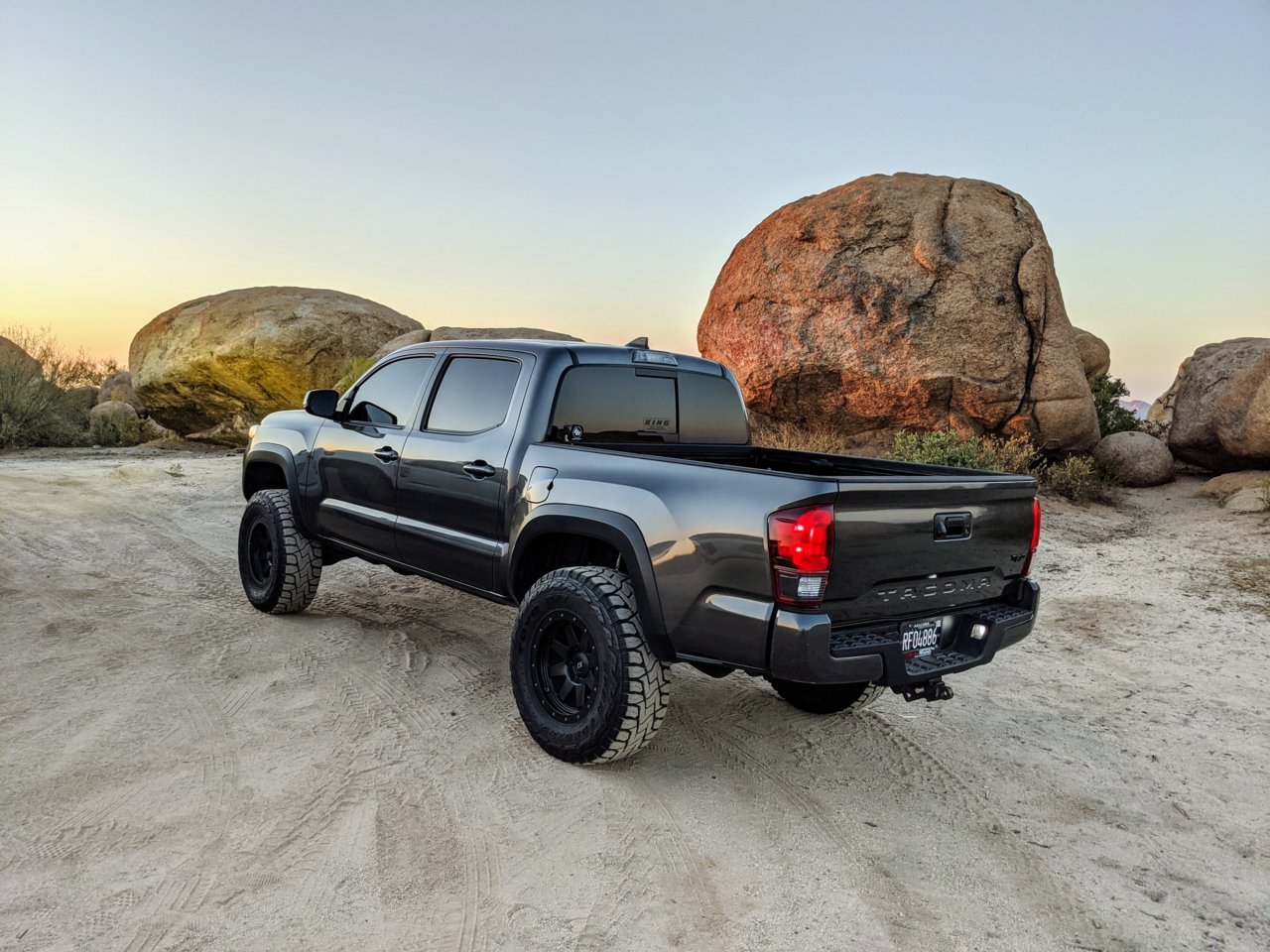

    Finally got a chance to shakedown the new setup recently. Everything works great together and the ride is incredible both on and off road.
    Front:
    2.5" King Ext. Travel w/ Comp Adjusters
    650# Eibach springs
    Total Chaos UCA
    Durobumps Bumpstops
    No sway bar
    Rear:
    Icon RXT leaf pack (option 1)
    Durobumps 3.5" Bumpstops
    Durobumps u-bolt flip kit

    That’s a pretty solid setup and hard to beat. Congrats
    T-rev[QUOTED] likes this.

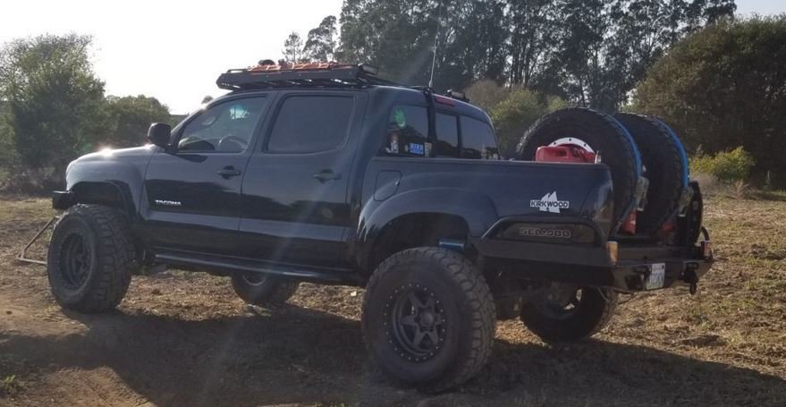

    I was hoping the same thing that I would not have to run them. At this point I do have 1.25 spidertrax spacers on the front and that is with the 285/75R17's on Stealth BR6's with -38 3.5 backspace. It was just to close to rubbing on the dual bypass tubes and with off road flex I would be risking damage without them. I am not worried about spacers as I have run them hard in the desert and have had zero issues. One thing to watch for is when you weld on the RR is to mount it as close to the frame as possible so you will not rub. I had to relocate mine so as to not rub and now my tower tubes are not as pretty as they could have been if I would have put them in the right place the 1st time. Even before I added the secondary shock the edge of the rim was just to close to the lower dual shock mount with the 16 inch rims I used to have so I made the switch to 17's. Lets not forget some serious CMC to get that extra clearance.
