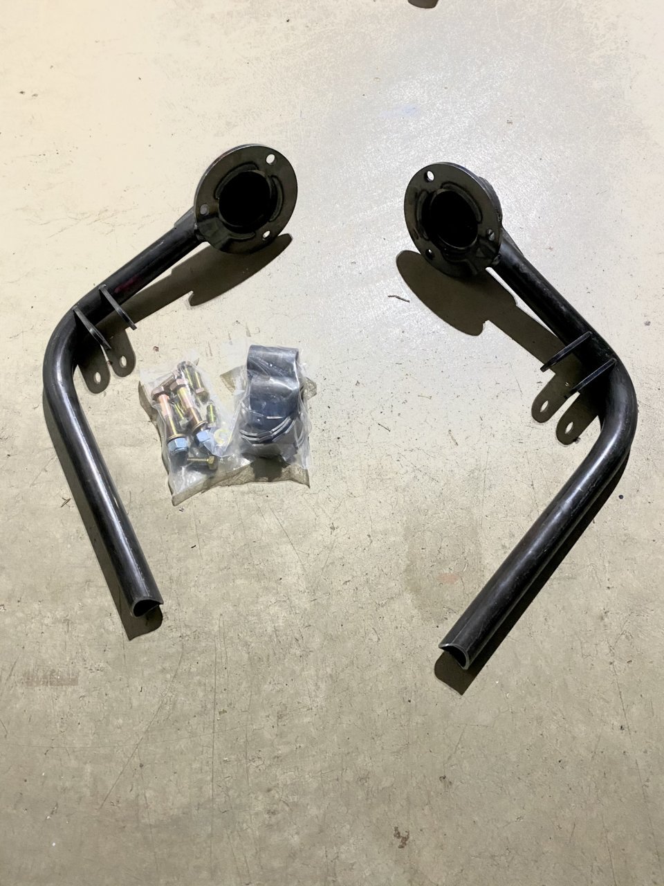

    I ordered up some TC dual shock hoops on Wednesday :bananadance:

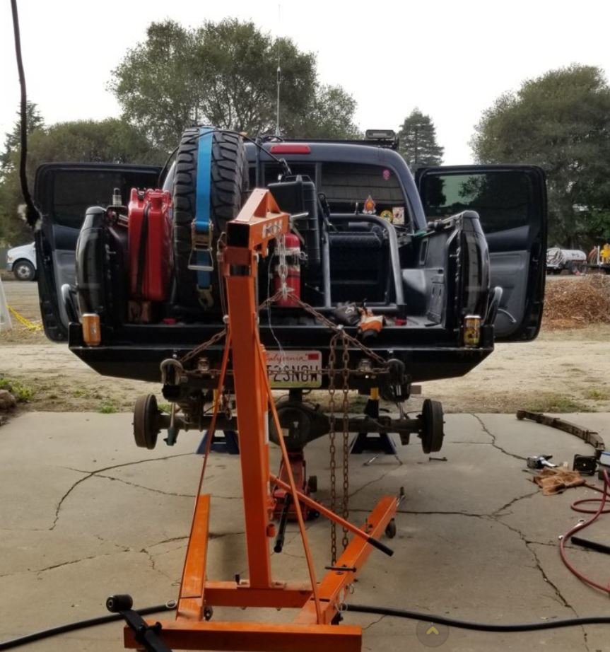

    Got the U402 Deavers in this weekend- picked up another inch between fender and tire- now just waiting for Archive to ship my relocate towers and HH with 3.6 shackles

    Who's bed rack is that?
