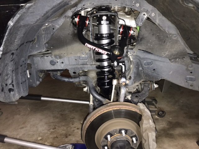

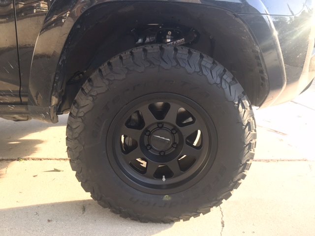

    134C1C73-1F7E-4DFA-B0DF-8606656E2E92.jpg 276E8BD4-14A3-4FBD-96A0-6D4639A84287.jpg E53AB916-AE1B-4B1D-AAE5-1156CD4166B7.jpg
    Not tacoma but close enough :D Put on some goodies on the new work truck; 2.5” ext. travel Icons w/ Dirt King BJ UCAs upfront and some wheeler 1.5” springs with 5100.
