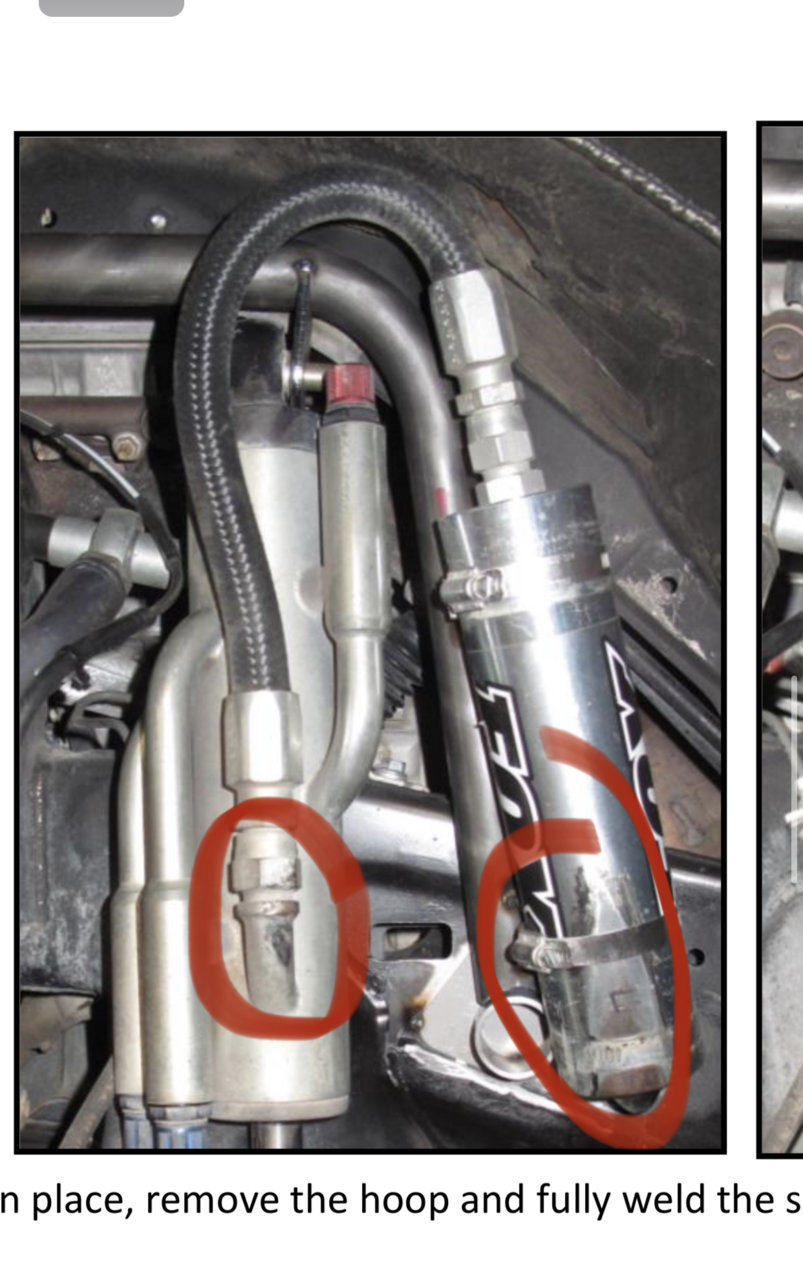

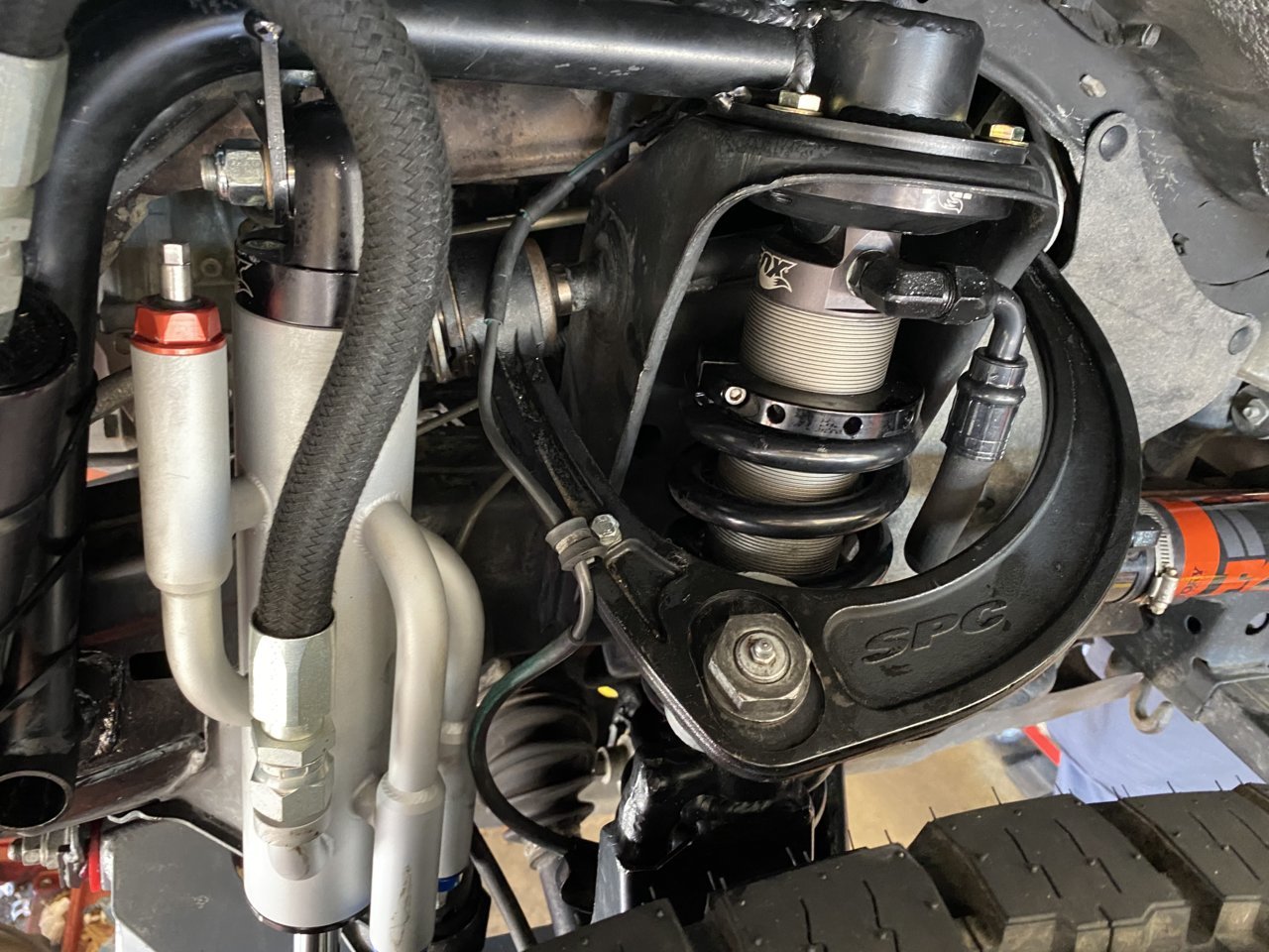

    but it looks like from install pictures on TC instructions they have rubbing issues. In the same spots.
    I loosen the two Allen screws at top of bypass and rotated it from the compression tubes were more forward. It helped a lot with the rubbing on the shock body. But still catching the corner of the resi.

    4.5 with a 1.25 spacer..(3.25 after spacer) spc upper position E.. I’m at 3.4 caster.
    I clear the cab mount after a serious chop. I recommend the relocation. Tire rubs on lower secondary shock mount on the tc LCA just a little.
    i need to replace the front bumps with wheelers bumps.
