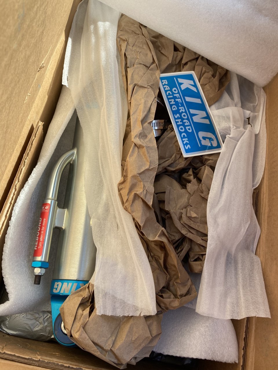

    Yes, 6" travel. I don't know the size.. here's a picture that the seller sent me
    check out Offroad Warehouse, they have 5% off if you give them your email. Or Downsouth will also give you a discount if you PM them here

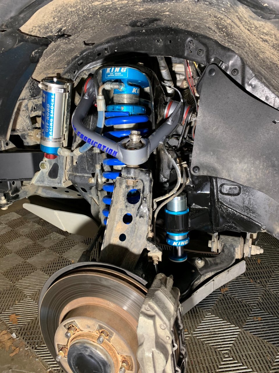

    Working on a set of DIY secondary bypass mounts, with the top hat of the mount doubling as an engine cross-brace mount too. Had to build custom ones in order to work around the bumpstop (will take some unique packaging to fit onto the LCA too).
    The engine cross-brace should also be fun with all the tight toyota packaging to work around... slowly but surely shes coming together.

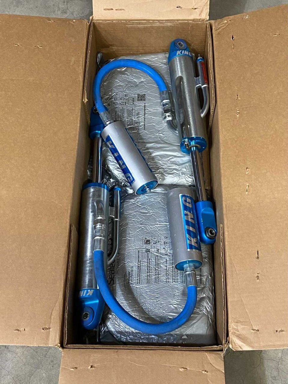

    guess who's got some blue paperweights coming tomorrow.. :anonymous:

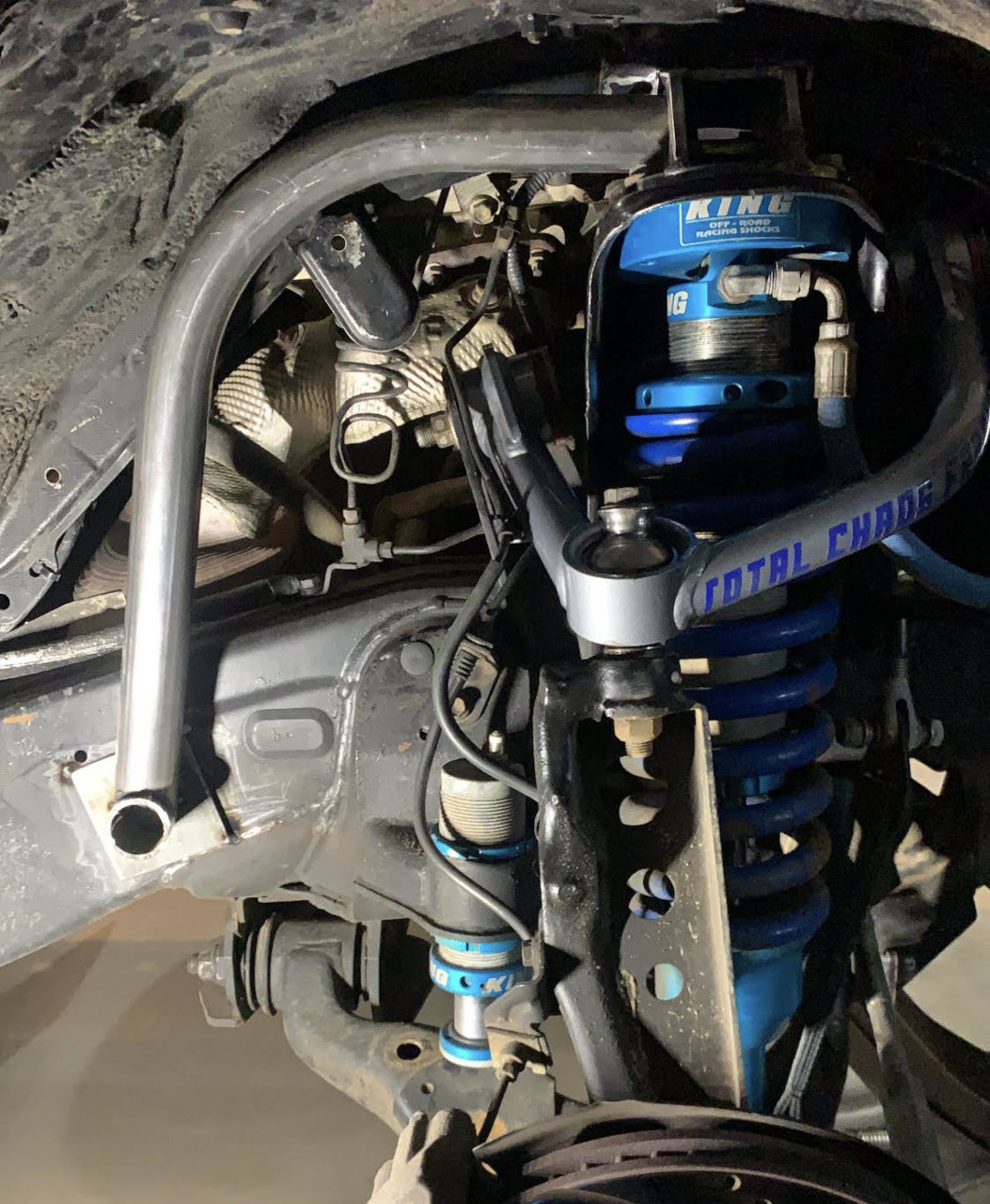

    Is it normal for the uniballs in the UCAs to have some play when turning or rocking the wheels? I traced this clunking sound to these movements in the uniballs.
    Total Chaos UCAs for reference.
