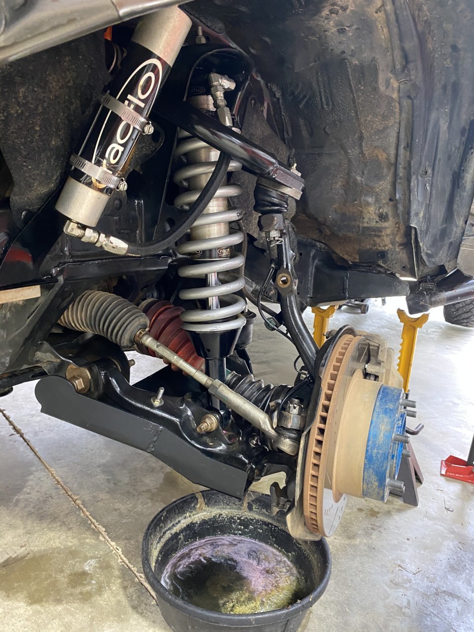

    I have changed my UCA uniballs a few times over the years. The clay dust/mud really eats them up here.
    Wheelers has the FK replacement uniballs for the best price I found two years ago (last time I replaced them). Although that might have just been the best price from someone that would ship to Canada. It's time to order another set and I'll probably just go straight to Wheelers.
    I use the AGM uniball tool to do it right on the truck. It works really well as long as they aren't seized; it's a very quick and fairly easy task with the right tool. It was quite expensive though, and my original uniballs were a PITA even with the right tool... I don't think ICON used any antiseize at all. Use it!
    Note: ICON uses slightly different uniballs than other manufacturers, but Wheelers has FK replacements for both.
    You'll probably want snap ring pliers too, maybe new snap rings. Both available at pretty much any auto parts store.

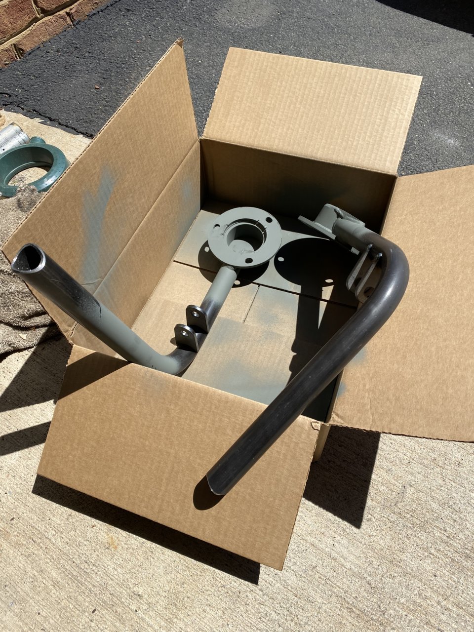

    A little painting today

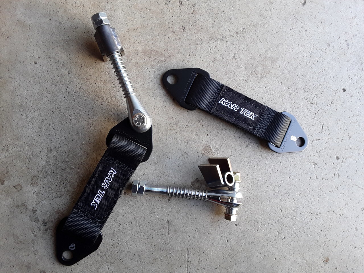

    I went with 9' straps and still have the 8's if you would like to buy with discount $20.00 each + shipping. I dont see any problem with the 8's i just wanted to set my cleavis mounts up a bit higher. I bought them from Kartek. You can find them on their site under suspension parts?
