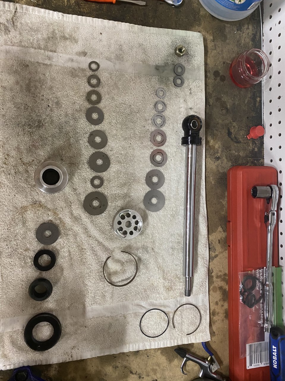

    Do they use a 3 seal bearing housing or just a two like Icon? I'm a firm believer that's why you see so many Icons leak.

    Are you referring to the seal cap?
    If so, it’s a 2 seal cap if I remember correctly. However, the seal cap houses the wiper seal unlike the wiper cap design that king and fox use. Not a huge fan of this because it leaves the seal cap itself exposed to the elements, but that might not really matter either way. Also has a thin o-ring that sits between the seal cap and end cap to keep junk from coming in around the threaded area, but that didn’t seem to do much.

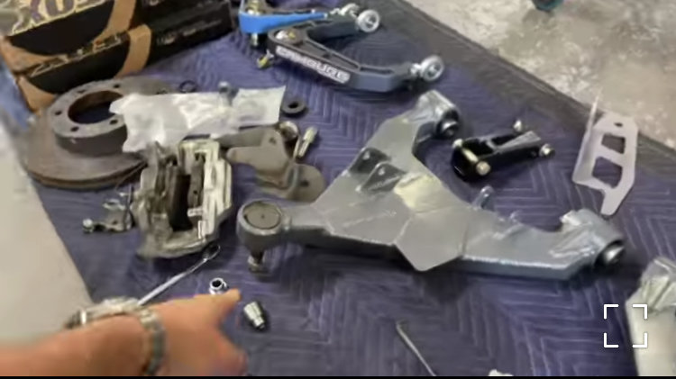

    Man if they didn’t tell me it was perfect for overlanding I wouldn’t have known. Also it’s basically a trophy truck because it uses the same bump stops.
    All jokes aside it’s nice seeing them make some big changes to their kit. Theirs was always towards the bottom of my liking due to a few design aspects. But this looks like a major improvement

    TBH I’d rather see a manly 4.5 over kit with fabbed spindles and race hubs but I know they’re in the business of making money.

    Of course, a 4.5 over with their fabbed spindle would be great. But it’s nice seeing an improvement in the market segment as far as mid travel goes. Moving the hub forward 1 inch and out 2 inches is nice for clearance, and that uniball pivot instead of bushings is a nice touch. I think that bump design is interesting. Since mid travel doesn’t have a lot of travel to work with, there might be some performance to be had by having such a massive bump setup. Might be appealing to some users not having to buy new shocks, but it’s definitely still a mid-travel setup.

    I don’t seen the advantage over a secondary shock but you say raptor and trophy truck in the same ig post and you can make it rain.

    It depends where it’s priced. Secondary shock on mid travel always seemed stupid to me because it’s a custom length to my knowledge and at that price you might as well go LT since you’re buying a new shock anyway.
    Either way, it’s niche product being marketed to broverlanders. So who knows :notsure:
