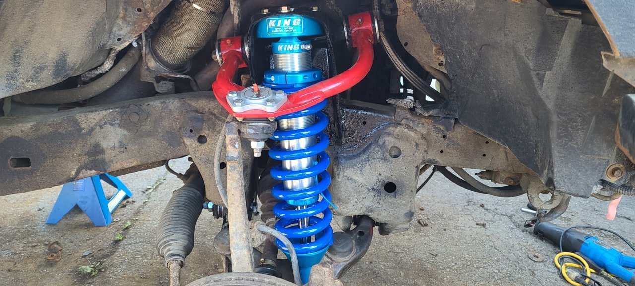

    I ended up ordering extended travel kings after. wheelers had them in stock. will install when i get home in a week
    Calamity_taco[QUOTED] likes this.

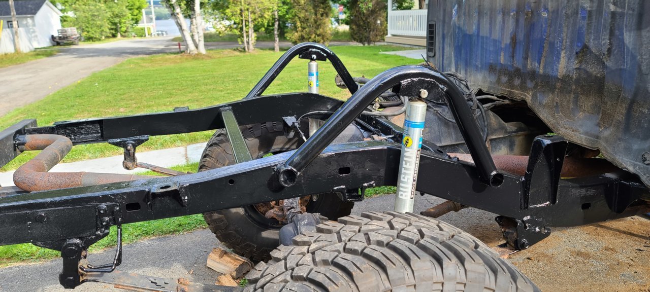

    What shock hoops are those?

    i made them. with my 1" body lift i can manage to fit a 14" shock in there
    04taccoo[QUOTED] likes this.
