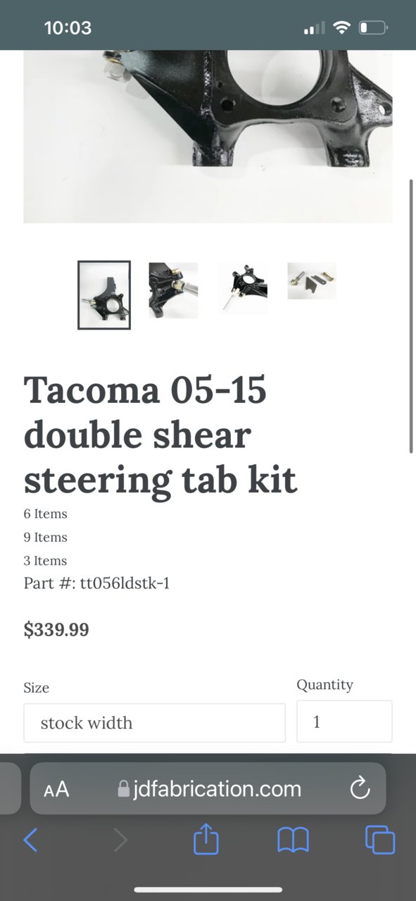

    https://www.tacomaworld.com/threads/singletrack’s-‘dad-shred-build-thread’-i’m-just-doing-it-for-the-kids.619250/ Sos offroad sliders (kickout + filler) Sos offroad full belly skids (steel) Sos offroad front recovery point Sos offroad concepts HC rear bumper with bedside kickout tubes Marlin Crawler LCA frame brace kit Trail Gear rear diff cover Bilstein 5100 + OME 885 Total Chaos UCA BILSTEIN b110 OME Dakar standard pack Wheelers Ubolt flip kit Wheelers Superbump f/r Wheelers SS extended brake lines FN five star 16x8 -25 Milestar Patagonia MT 315/75r16 Custom projector retrofit (acme super h1 + morimoto 4300k) Baja Designs S2 sport ditch pods on CBI ditch pod mounts Amazon AMAK rock lights CMC CB radio hardmount
    Let me know and I’ll happily ship. Still in original JD Fab box. Stock length version

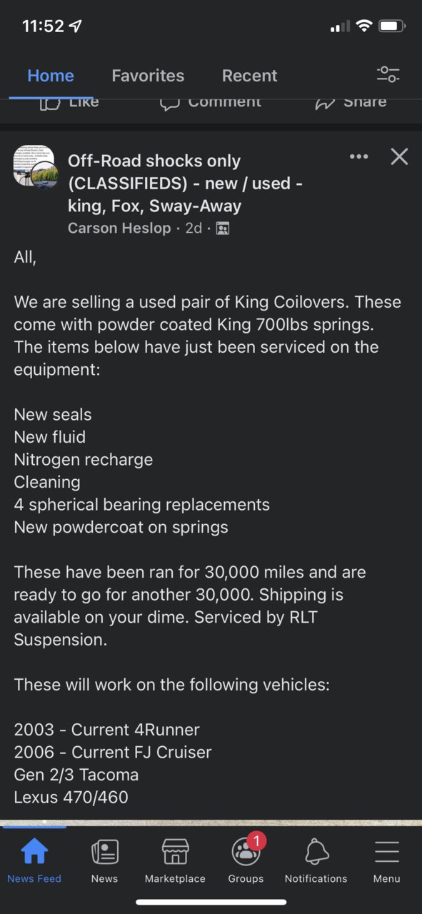

    Not mine, but a fair price IMO considering the condition, that they were just rebuilt, and current availability of new ones.

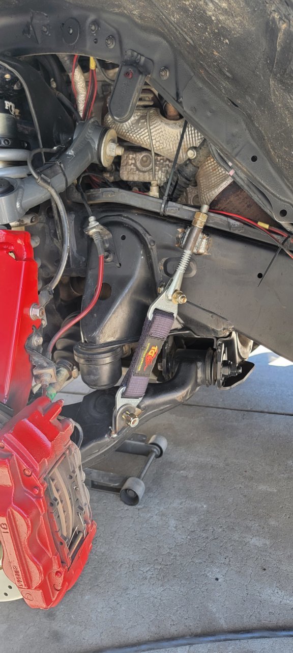

    Hello Mid Travel experts, hoping you can help a noob with some (probably) dumb questions so I can join the MT club.
    1. Front: Currently only 6112's at stock height, +1 brake lines from Headstrong/Crown kit. Going to add UCAs, probably JBA or SPC as of now. I can't find the answer anywhere but will I need limit straps to prevent overextending the shocks?
    2. Rear: Currently on sagging TSB rear leafs and 5160s, already have +4 brake lines. Planning move to Deaver U402 stage II with some Archive U bolt flips. Planning at least right now to keep 5160 until I get leafs installed to measure for something like 7100 smoothies to go with shock relocation towers. Of course I know 5160s won't be long enough and it seems like some people run them and can survive mall crawling. I'm not expecting to offroad during the short time while I wait to order the longer shocks - how much danger are my 5160s going to be in? My daily commute is all pavement in metro hell and I drive like a grandpa.
    3. I don't see much talk about axle shimming on the U402 setups like I am planning. Thinking I should still order them to have onhand and be prepared. Stupid or smart? Other thoughts/comments?
    Thanks in advance to all the cool kids with grownup suspensions!
  19. Jan 24, 2022 at 1:08 PM
    #5979
    Buttskevin21
    Buttskevin21 Well-Known Member
    Dec 14, 2020
    #349654
    2,490
    Kevin
    Washington
    2019 Brocoma, 37s, Lt, Dual Tcases, blah blah blah https://www.instagram.com/kevinjbutts/
    Stock-ish
    5160s should be fine. And on the front end, the shocks are almost always the limting factor, so they are always being topped out on extension, rather than something else stopping the travel. Most people dont run limit straps in the front, but I do since my truck frequently sees the front tires off of the ground an it makes it a whole lot quieter of a ride with straps instead of the shock topping out.
    Vegasstunts and wi_taco[QUOTED] like this.
  20. Jan 24, 2022 at 1:13 PM
    #5980
    Vegasstunts
    Vegasstunts Well-Known Member
    Dec 27, 2019
    #314287
    751
    16 TRD sport
    All of them.
    I agree with this post. If your daily and or medium trail running your truck then they are not needed. But they are relatively cheap to put on and if your tires ever leave the ground it definitely helps your shocks last. 20210804_131433.jpg Screenshot_20220110-121836_Photos.jpg
