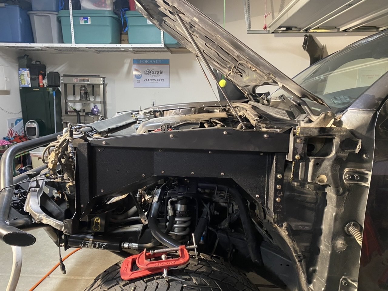

    JDFab inner fenders give you all the clearance you’ll ever need.

    Cool kit, but I will just tub mine when I do either a straight axle or lt, and bump up to 37s
