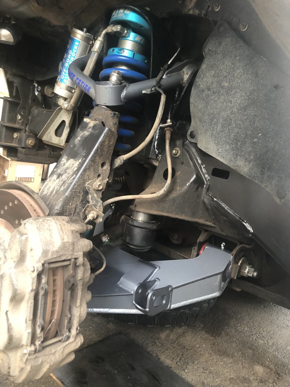

    nice..I have that set up but in Fox. They are a 2.5 triple. Only problem and you may have this too, is at full lock the tire rubs on the LCA secondary shock mount.
    I have 35” tires. With 33s there was no rub. I have 4.5” of backspacing with a 1.25” TC said 33s was the intended use. 35” I need about 3” of BS which is a 1.5” spacer with my set up.
    just giving you a heads up if you go the 35” route.

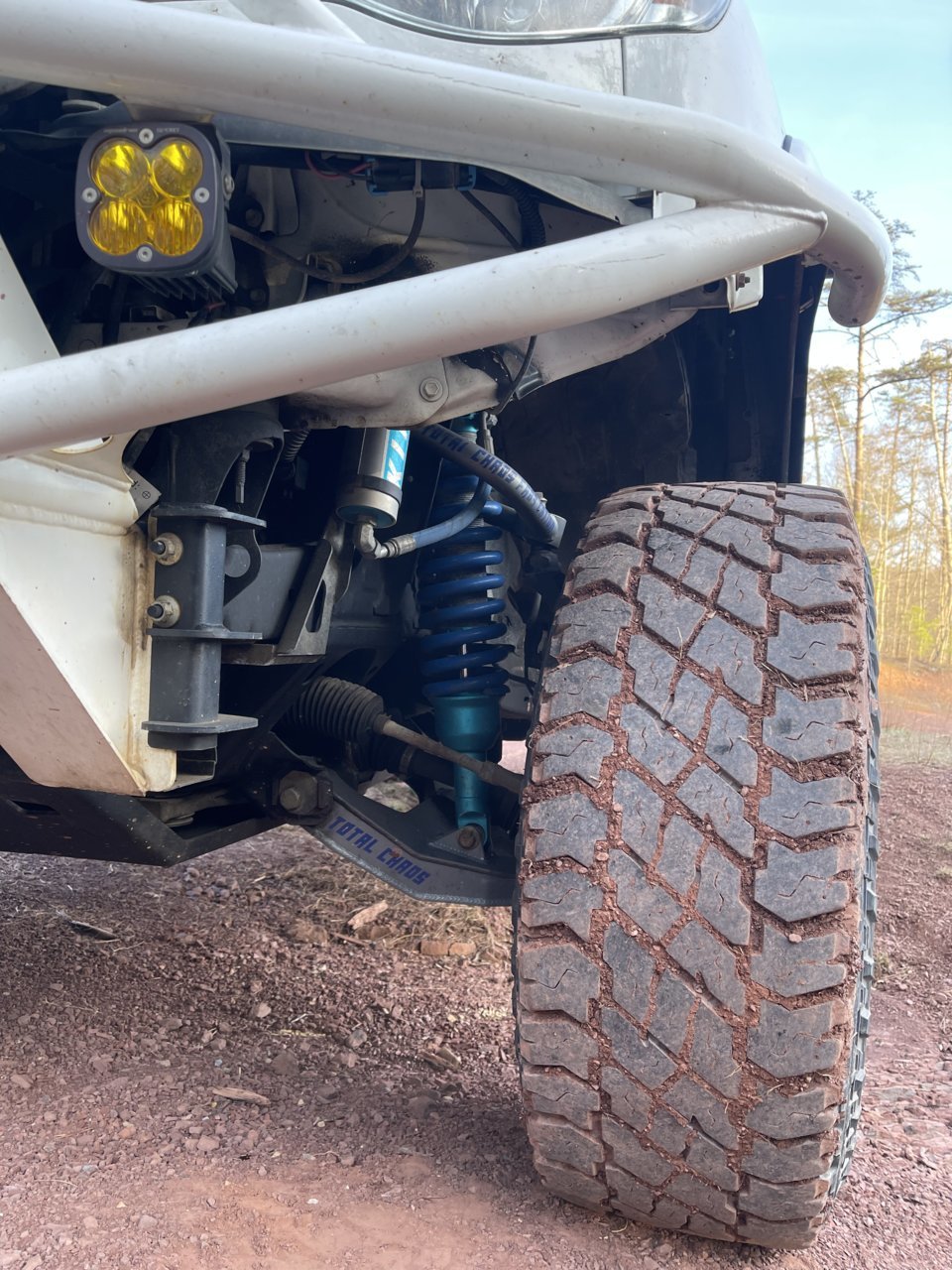

    These are 315/75/16 with 3.5BS. I dont have any rub on the LCA, just the top of the fender wells, since I haven't clearanced those. Did a major cmc and flattened the pinch weld. Front fenders and flares are trimmed 2" too.
    My tires have about 45k miles, but will probably be getting STT pros in the summer, and selling these for cheap
    Bypasses that are going on are 2 tube

    I’ll send you a picture. I have the same tires. It rubs on the bolt primarily.
    maybe you have a different model LCA. I know they made multiple for the Tacoma

    I have the dual shock mount Expedition LCA. Ive had them installed for a year and a half, no rubbing/issues. Bypasses are not in yet. Just ordered the valve stacks for the coilovers. Pretty sure ill have plenty of clearance

    Damn!! We got the same set up!! And I got rub.. With 3.25 BS. That a 12.5” in tire?
    the bolt will stick it out about 1/4”.
