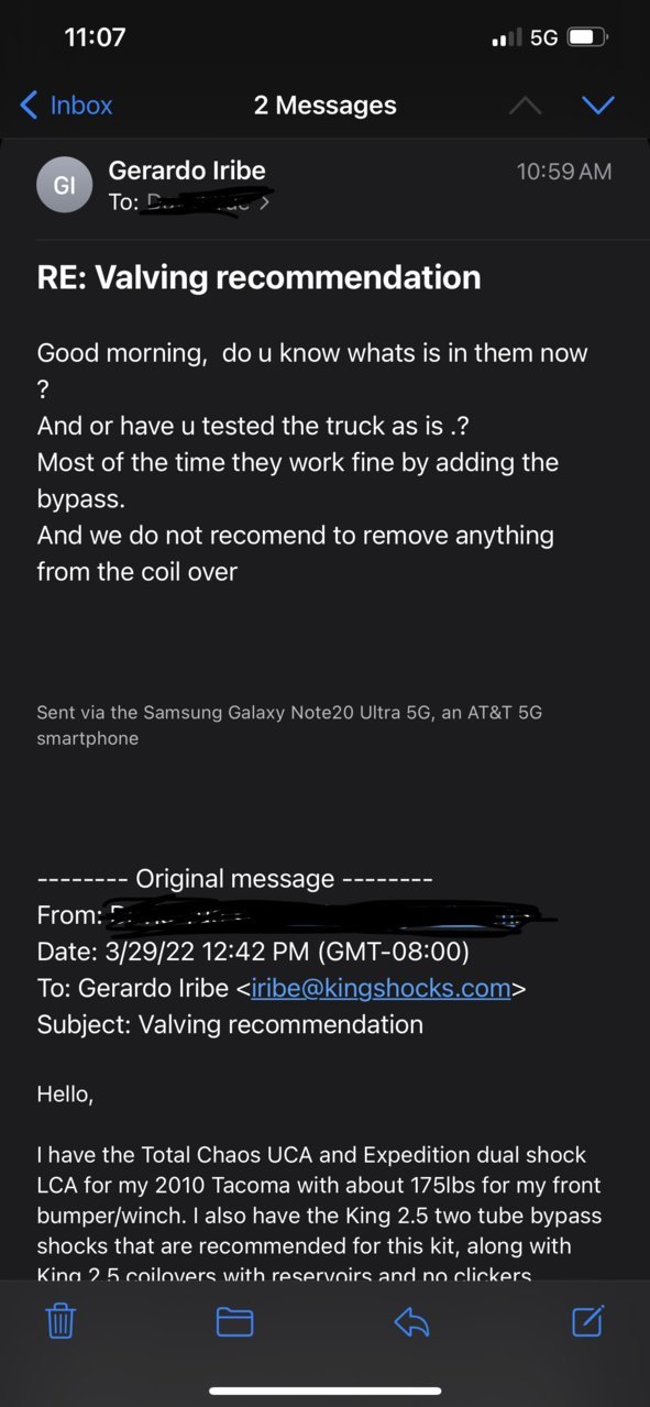

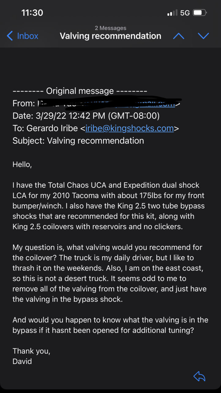

    What was your entire email to them? They might not be wrong. A two tube bypass will give you additional bottom out control and a catch zone but the C/O will be provide the primary damping control. At least you now have multiple options to try.

    Heres the rest of my email:

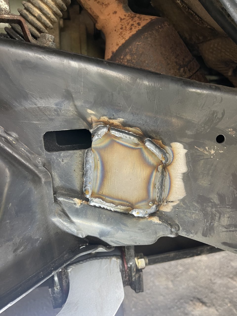

    Wife got the goods for her 4runner yesterday.
    And her welds on the spindle gussets weren’t half bad. Made her do all welds on the back side. 82E0E176-DA08-46F5-AE12-0F40AC2937AF.jpg

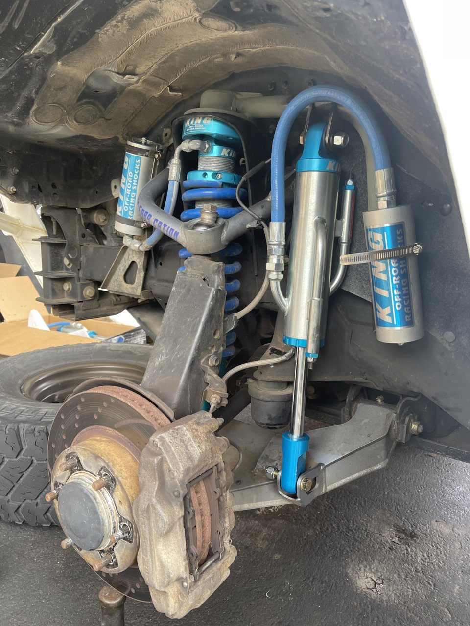

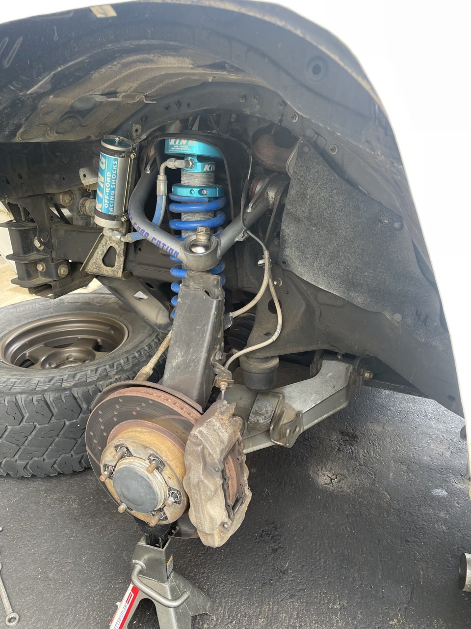

    Some test fitting happening today..

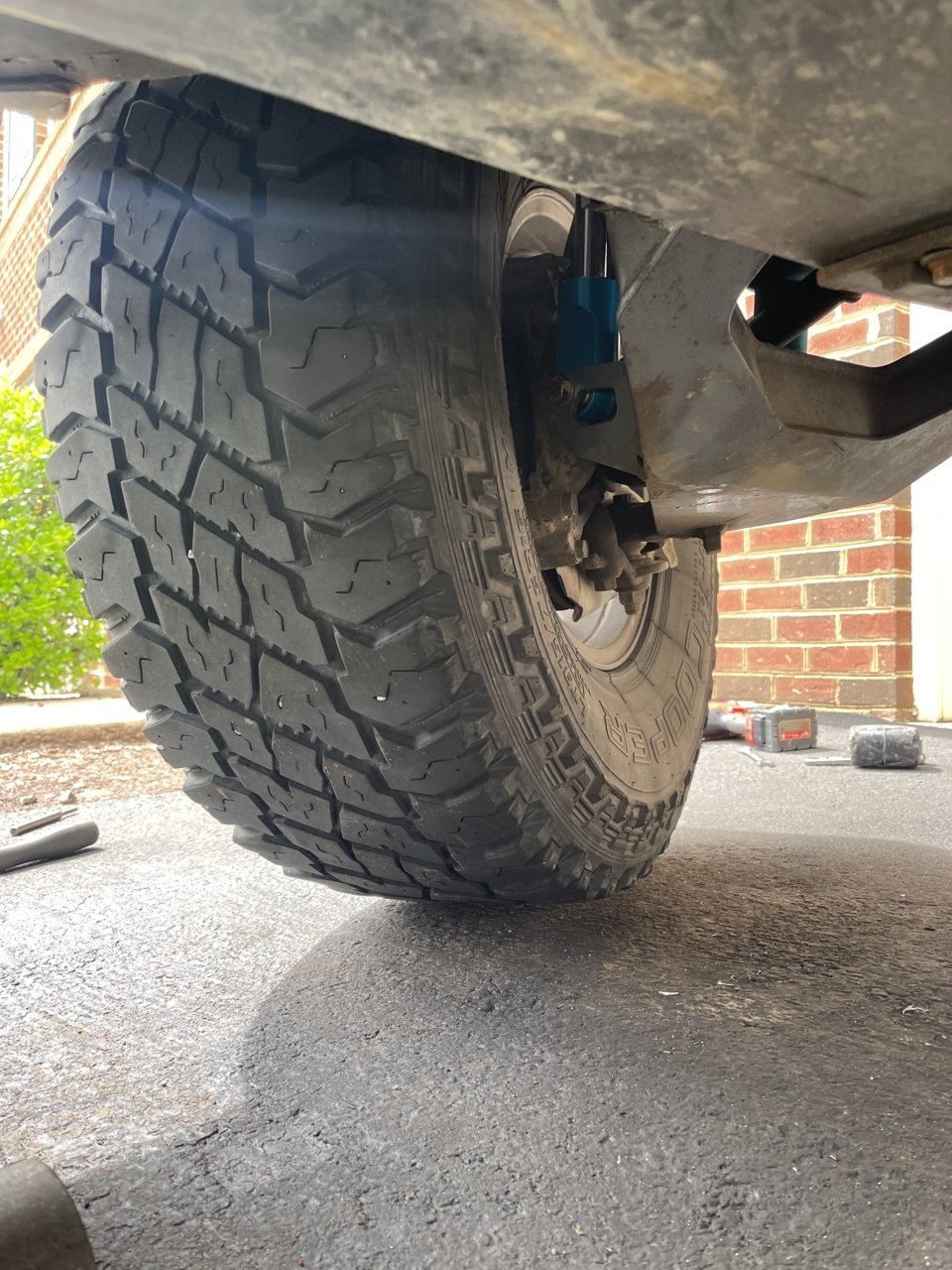

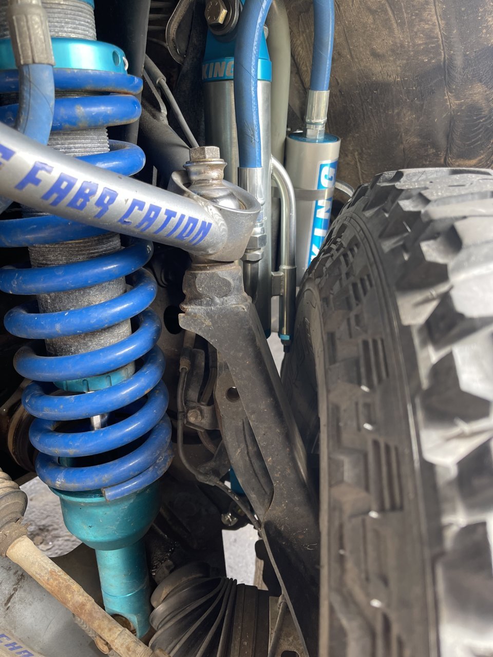

    Well shit, im rubbing. @cdex8357 its not the lower mount though, its the compression tube?
    maybe need a 3/4" spacer?

    Your secondary shock bolt is loose.

    I am in the first test fit. Nothing was welded or tightened. I have some rubbing, and im not at full lock. I think a 1/2 or 3/4" spacer would help? See above picture
    Wheel/tire specs: 16x8, -25mm offset/3.5BS, 315/75/16

    Gotcha. I think I had some rubbing on mine as well. 4.5 BS on my rims (don't remember the rest of the specs now) the only thing that remedied my rubbing because I knew it was going to happen anyways was 2" Bora spacers.

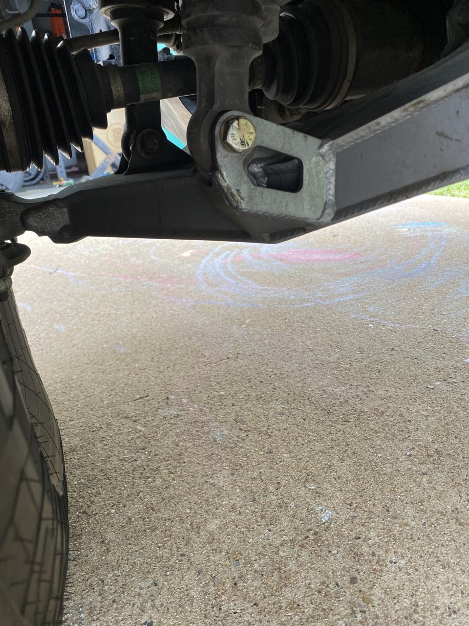

    Decided to make a little progress
