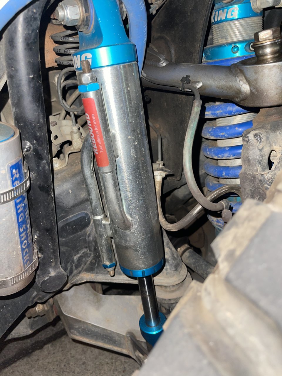

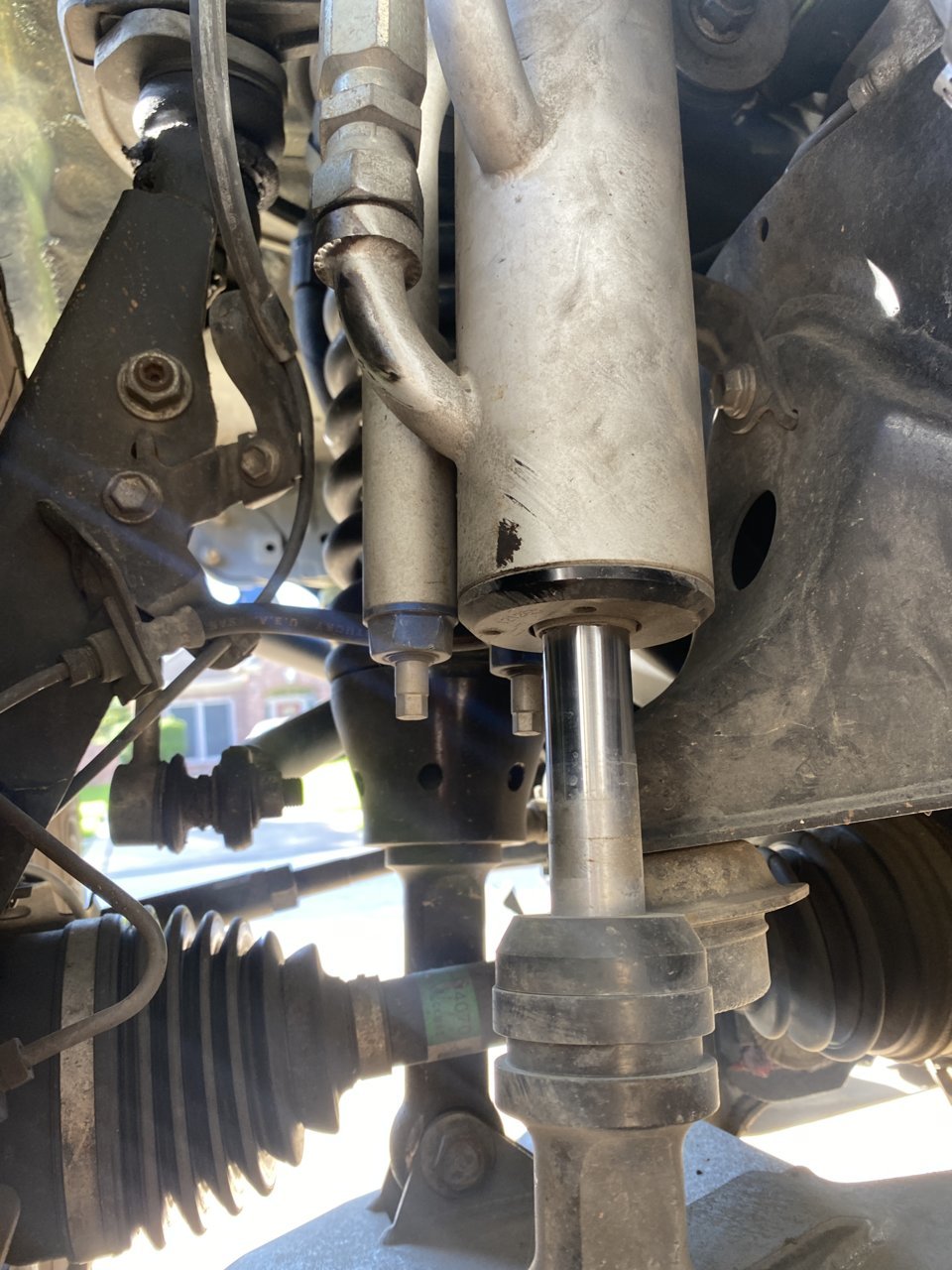

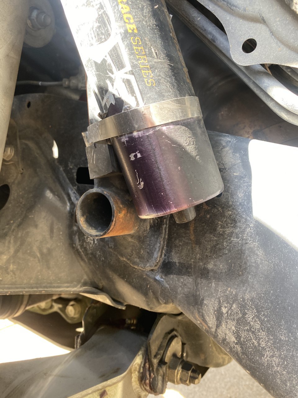

    Yeah bro. This is the issue..
    I rub on my compression tube and some times at the edge of the resi, fox has longer resi. And on the lower secondary mount of the LCA.

    I have you same tire combo with a 4.5 BS and 0 offset. You may be good with a .75 spacer. I don’t know how a .5 spacer would work since the lug nuts are about .5” or little larger.
    @nudavinci64 had this set up working with little to no rub. I don’t know how set up. He is not LT.
    I think you BS need to be around 3” or 2.75” to full clear with 315/75/16. When I had 285/75/16 I had no clearance problems.

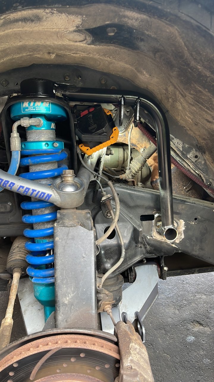

    Just got one side welded in. Forgot the resi mount, but thats not too hard after the fact. Dont judge my welds. They're not pretty, but they're strong :pout::muscleflexing:

    E3114BCB-BAC9-49E4-BEAA-F277B762803A.jpg 306CDABB-409C-49E2-8E66-6AAEE840943F.jpg

    hey, you’re putting in the work and welding is an obtained skill. I applaud your efforts. It should work out just fine even if they aren’t pretty.

    Do you have a rotatable body cap and why not just move the resi a bit?

    i rotated it as far as I could. Compression tube is a just cunt hair off the frame.

    Flip the bypasses to the other side and turned around. That tune will nest inside. I had the same issue and went away after that. But not after it spun the adjuster off.

    Orientate them like this and you’ll be good.

    I halve 3.5 BS if not you need to run a spacer but biggest even then I had rubbing and flipping shocks around was clutch. posted that photo but no longer have it on. Went to a +2 kit. Need to post it up for sale.
