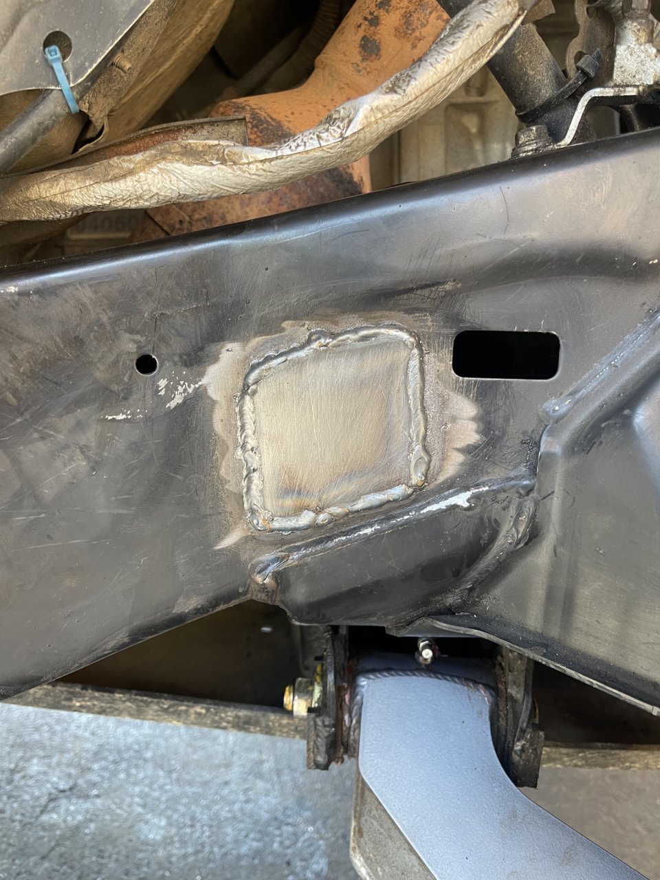

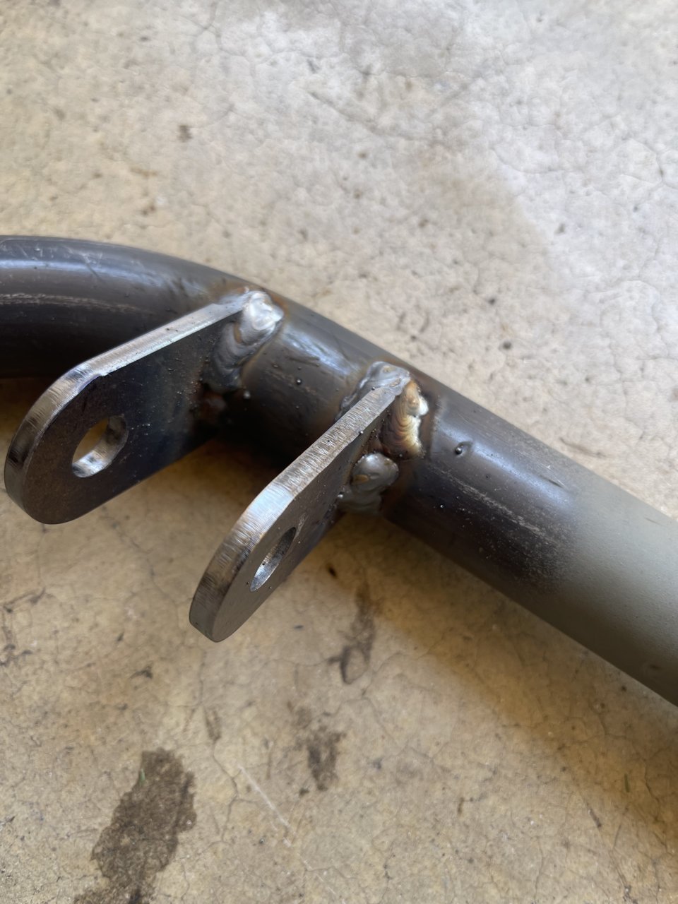

    Welds looking a bit better today. Although I tried a different side shock, and it didn't look like it would fit without rubbing. I did not test fit the wheel this time. Only need to burn in one more thing and then it will be mounted to the frame. May even have time to call @TOTAL CHAOS and ask for some advice..

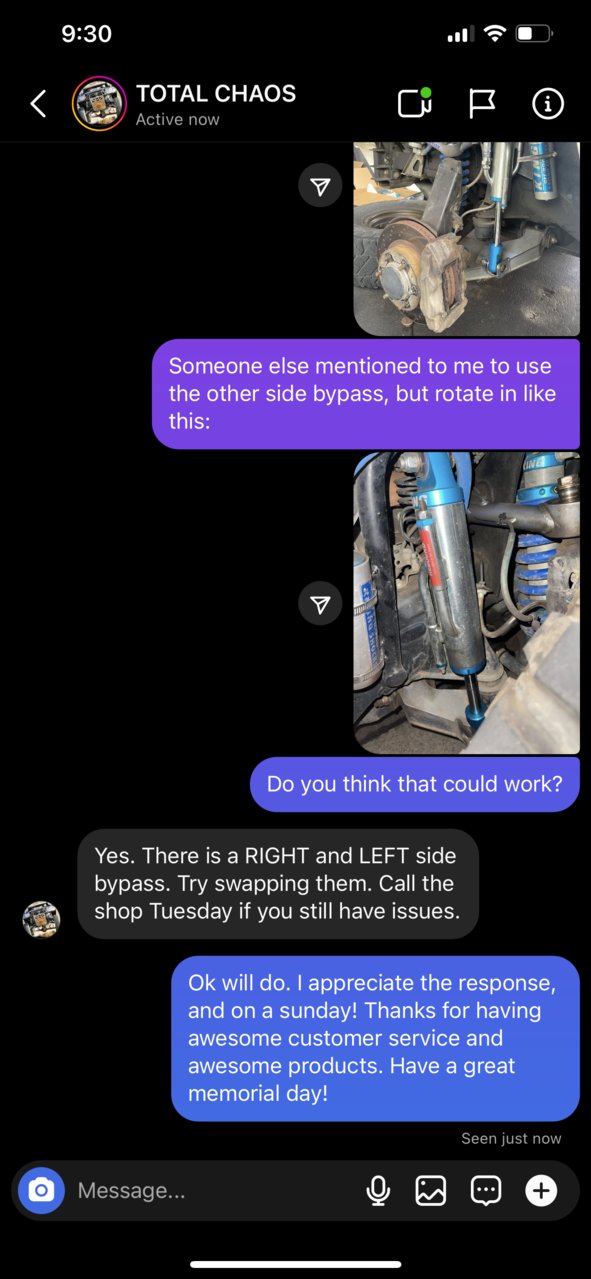

    I just called Total Chaos and Pat picked up on the first ring. He's going to identify if I have the correct bypass on the right side. Also confirmed that I probably will need a spacer.

    So Switching sides is it still rubbing on the shock?

    I tried it, and it seemed like there was less clearance. Although this time, I didnt put the wheel back on and go lock to lock (too damn hot, sweat burning my eyes). Total Chaos also said they were in the correct configuration, but with 315s Id likely need a spacer.

    I run -38 as well so makes sense. Yah we’ll see if he comes back that’s who I talked to in person and sent photos and no one picked up on it. but swapping it like I showed you will put you in the perfect spot. Even with -38 I was rubbing before I did it. You’ll have more room. Not much room at this tire size and offset.
    4.75 offset +1.25 is what they recommend for a spacer which is 3.5. So if you have 4.5 you will want to run .75 minimum.
    they also had noted they were not fitted for 35’s when those were added as well so there is that. but I would swap them you will still run with a .75 spacer. If you back space is 4 then .5” should work. But assuming your not 9” wide wheel as long as Bs is around 3.5 should be good.

    @fatfurious2 I read back you are 3.5” BS. I would really swap sides and see if that solves it. Mine was still close but problem free. .5” will prob help but may not be needed. Make sure to weld the tabs for resi tucked away. I was also rubbing there before it changes it.

    I have 16x8 -25/3.5BS and 315/75/16. Hope the 1/2" will work. It looks like minimal rubbing, so if 1/2" from where it rubs, then hopefully it will be good.

    Yah if you swap sides/rotate and add 1/2” you will have a ton. Mine seemed to clear but when you put load on it then it rubs.
