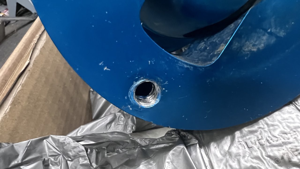

    Can you rethread the top of my king coils? Not sure if the whole top plate is aluminum or if it has to be replaced.

    That can be fixed with a proper heli-coil job.

    Heli-coil like stated above, drill through to 3/8 and through bolt it, or tap it to 10mm.
    You might be able to run a longer bolt to grab threads that may be in tact at the bottom of the hole.

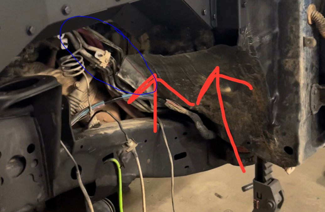

    swiped this picture from another thread.. Anyone know what these lines are? (in blue) I may have grabbed them with pliers when I was bending back my inner fender. I dont think I nicked the lines, but there is a marr on the coating of one..

    https://www.tacomaworld.com/threads/airdogs-2012-prerunner-access-cab-slow-build.264263/
    Fuel lines

    2010 TRD OR Access Cab
    hmm, so definitely not good if I happened to grab with pliers. Ive been checking for leaks and smells, but havent found anything. :fingerscrossed:

    Olympic Peninsula
    Ahh, it’s only next to the exhaust manifold. Just drive without passengers for a while
