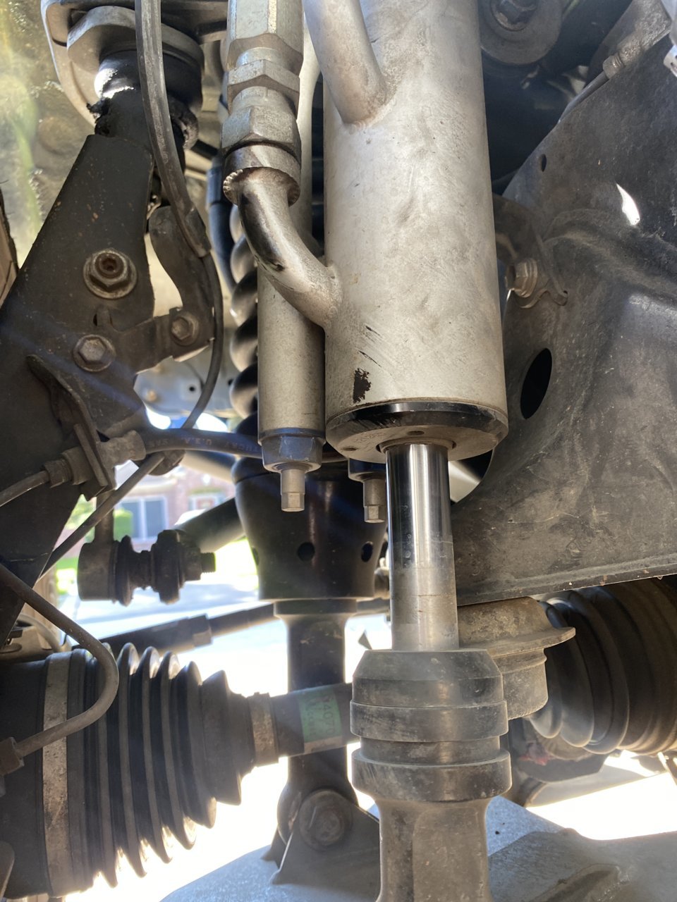

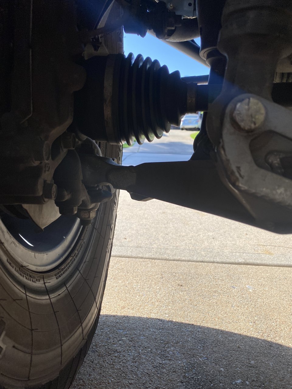

    AC02EF59-8B9B-4E6F-A7A2-1312F7BC9C95.jpgOuter ring on the tire is the LCA. Inner is where it’s rubbing on the bypass 9B1EC17D-95B8-409A-A603-63CD02D4BDD6.jpg

    @TOTAL CHAOS its kissing it. I wanna do the scs wheels, 17” 3.5 BS but been debating it cause it will be more rubbing isssues.
    I am also on a 315/75/16..

    It does look like it's not too deep so the quick fix is adding a larger spacer. Getting wheels with a different backspace will also fix it but i would work with those spacers to make sure you have the correct spacing before investing in new wheels and having it come up shorter than what you expect.

    I had similar issues and we looked at it in person at FJ summit a few years ago and at least with King setup and 315's rotating and flipping the bypass solved the issue for me. I only went higher offset wheels so I could not run a spacer.

    You had the SCS with the 3.5 BS. Deep dish. I may try flipping them. There is a smooth side

    I can look. My steering stop or lack of area still rubbed at full lock near there but not anywhere else. on the LCA. Most of the rubbing was on the bypass tube and resi. Once I moved them around (after having one of my bypass adjust loosen off from the tire turning it). It was fine after that. I then move the resi over a bit and never had issues after that. I think when we chatted you were going to go with spacers and a diff offset y0u had.

    Spacers I went with 1.25.. I’m Gonna try 1.5 with current set up. I really want those scs deep dish wheels. But don’t want more rubbing issues.
