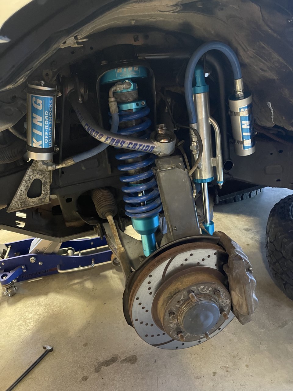

    Still need to do the rear shock relocate and install the 2.5x12s, but the front is all set.

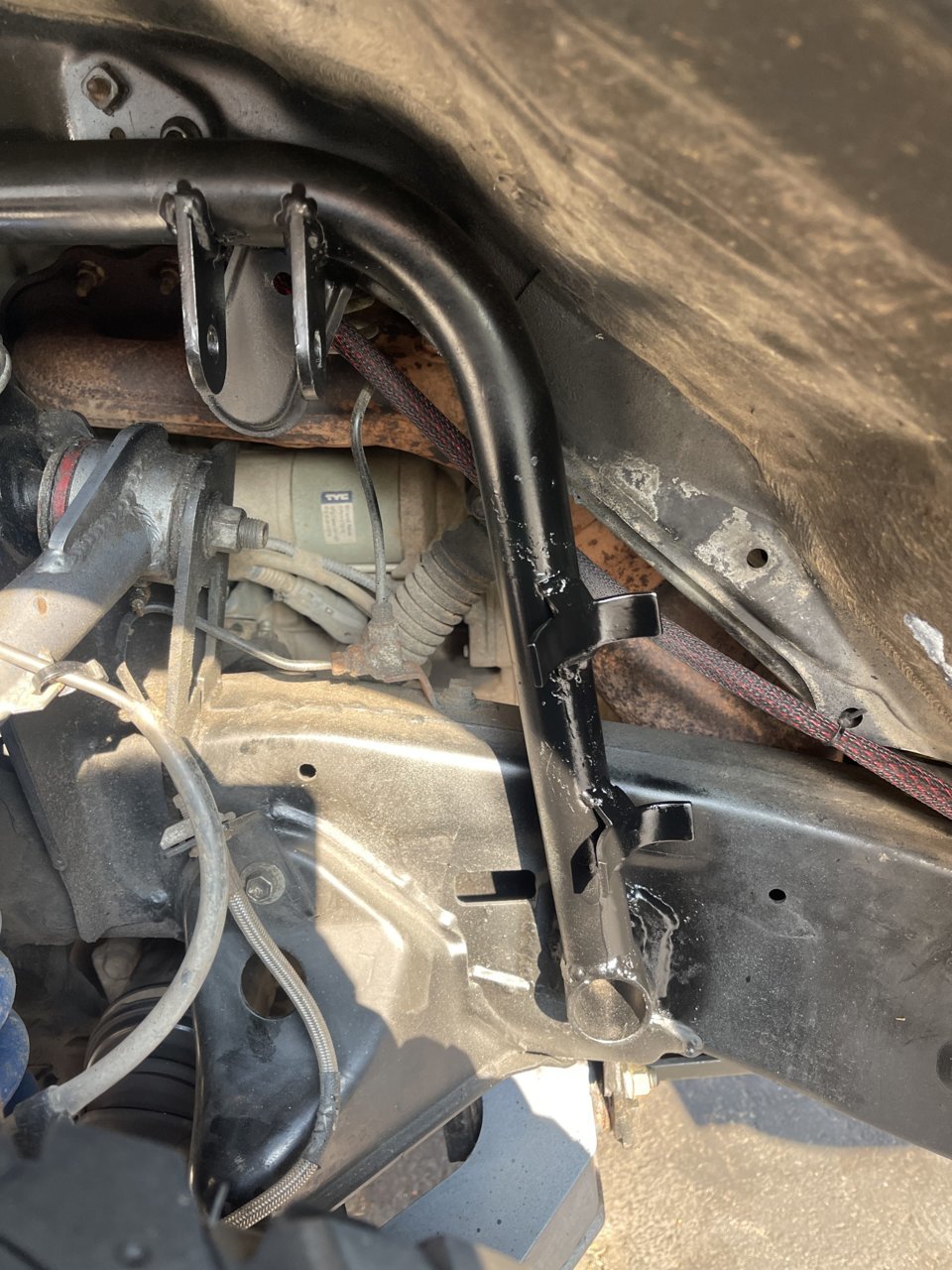

    What’s everyone doing for replacing shot LCA bushings? Anyone make poly LCA bushings? Don’t want to drop $2400 on a set of TC LCA just for the bushings & stock length.

    I took an old set of LCAs, replaced the ball joints, welded up the holes and around the eyes where they've been known to fail, added some limit strap mounts, pressed in whitelines, and added grease zerks.
    They've been flawless for a few years now.
