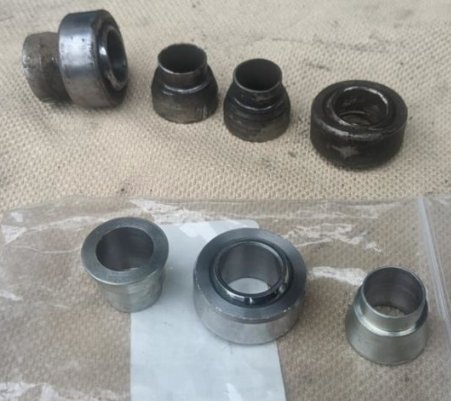

    How old are the aftermarket parts? Could be UCA bushings or uniball. I had almost the exact issue and found the lower shock bearing to be worn out with a lot of play. Popped in some new ones and all was good.
    old vs. new:

    I had a similar issue. Couldn't get a good alignment... then figured out that my lower uniballs were TOAST. The ball almost fell out of the spherical cage when I removed the lowers .... :facepalm:
    New uniballs and magically, the alignment worked.

    About 10k miles now. Truck got new lowers and cam hardware with suspension. Uniball about the same on both driver and passanger side, I was thinking maybe not enough pre load on it, because it only clunks when coilover are extended. The paint marks on lower cam bolts have not moved.
