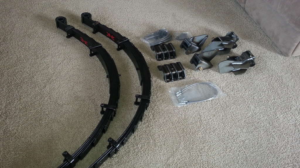

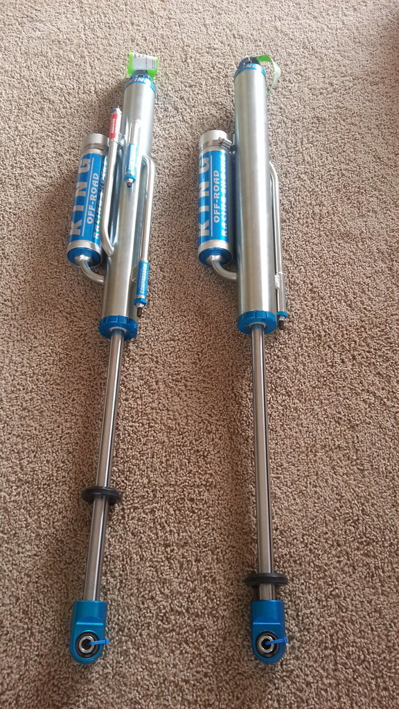

    Finally going LT

    LT in the MT thread o_O

    hes basically giving us the dueces. Talking behind our backs, yet right to our face! :(

    Trying to tempt us.
