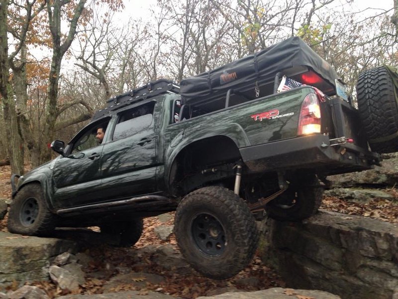

    You should really go take drivers ed again...your tires are flat and you keep driving into holes and rocks...amature

    ^^^^ I like the picture because due to the angle I can't tell if he is going to roll off that ledge or fall and smack the bumper and spare tire.

    Hasn't been a problem in a years time. I was just outside and took a look, I removed the bolts on the two most center clamps.
    It happens...
    I totally smoked the bumper coming off that ledge.
