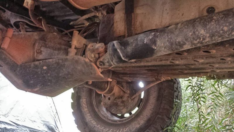

    I have no complaints with the BAMF one. I was a little worried that I would catch on the front lip, but it's been good so far! Does anyone know why he stopped making them?
    The BAMF one ^^ is pretty tight to the housing, and I don't think you lose too much clearance at all. maybe 3/4'' if I had to guess... but I guess every inch counts right? :notusre:

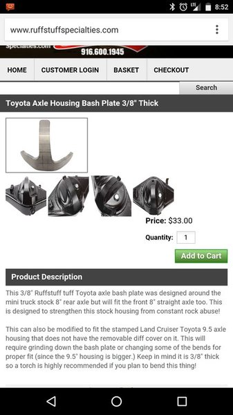

    Damn good price!
    Crom and stumbles like this.

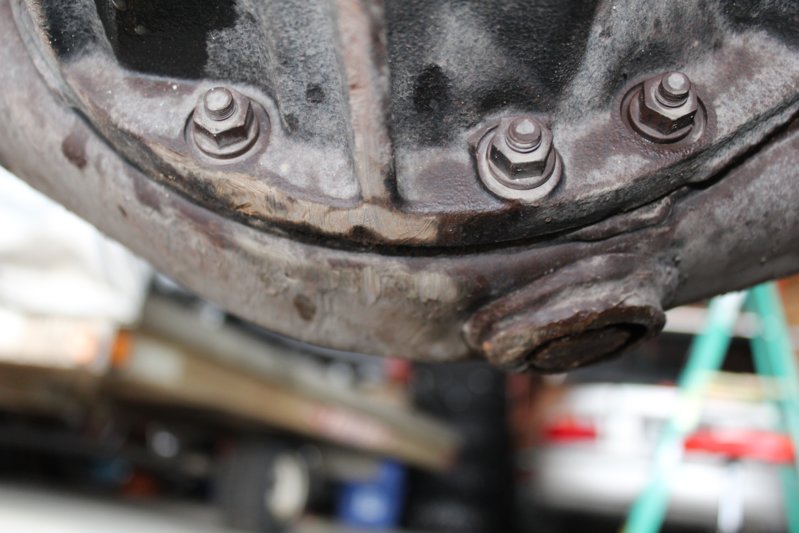

    I would also add the drain plug as a weak point. I ended up grinding the ring around my plug down so much I was hitting the plug and loosening it on the trail.
    I don't like the idea of a diff diaper for many reasons, so I welded up a little piece of 1/2"x1/2" steel to act as a sacrificial piece and try to keep rocks off the plug.

    Good point on the plug. I use an aftermarket plug that All Pro sells. It's doesn't bulge out as far as the factory one and uses a 10mm hex to remove so there are no edges to snag on rocks.

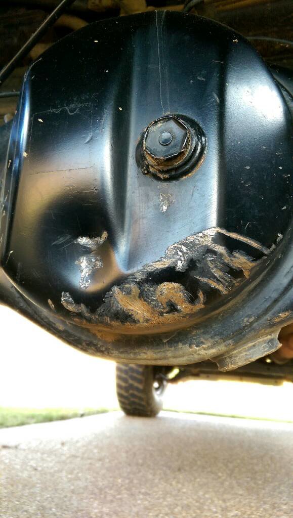

    Exhibit A .....

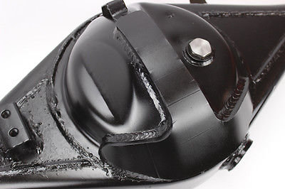

    Blue torch fab makes rear diff armor too, pretty dang tough. It doesn't fit the e-lockers though only the older 8" diffs. I think I'll run that on my 4runner and just build one for the tacoma

    Sat evening, Chick-fil-A parking lot. Had to take drastic measures and hop a parking spot curb. If only I knew then what I know now ........ *sniff* .......
    Sounds like my build thread ....
