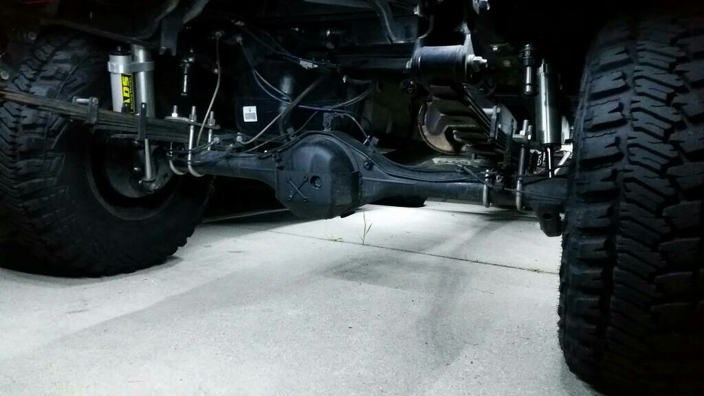

    Late to the diff skid party. Here's a pic of the TG diff guard. wrenches not included... @loco is just a asshole :anonymous:

    Do you guys have a problem with crap getting stuck in those? Or is there a drain in the bottom?

    Few drain holes. I just be sure to rinse it out well whenever I wash the truck.
