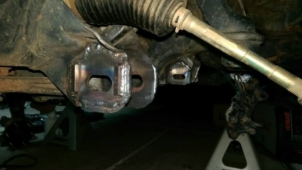

    Speaking of which, I just welded these on Friday ....
    I haven't had a bad experience with firestone. The one I go to has a tech that does a great job. Gets the numbers I want every time. I have their lifetime and have used it 9 times in the last 2 years as I get an alignment after each off road trip. Although the tech hasn't flattened my cam tabs, the rocks on the trails sure did. I hit something hard enough to sheer the heads off three bolts that hold my lca skid plate on and bend my cam bolt and flatten the tab. I may not be able to prevent the bolts from breaking again but hopefully I won't have problems with tabs anymore cause this wasnt the faster project I've ever done. Haha

    Took us 3-4 hours to do the tabs. A lot of work

    Because i did it this weekend and was really surprised at how stretched they were, check your limit straps. I had them installed a little tight so they would stretch on some typical driving. But wow, i had to adjust them quite a bit to make sure my uniball posts didnt hit the cup and everything was kosher. I also de-cranked about a 1/4" to recenter the uniball. All is well now.

    Took me longer then that but by myself and I also took all the front suspension off both sides to do some other things like spindle gussets, SDHQ axle boots, poly urethane lca bushings and new lca ball joints. Soooooooo I'm not really sure exact how long the cam tabs took. I just know it's too long
