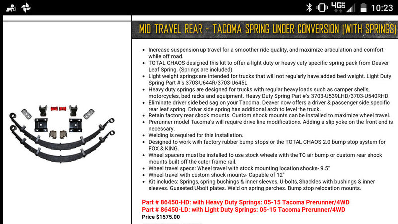

    Screenshot_2016-01-19-10-23-52.jpg So I am looking at this total chaos MT sua kit for $1575. I contacted Deaver and they said they sell these springs for $850...and total chaos sells this kit minus Springs for $575...
    http://www.chaosfab.com/2005-2014-Tacoma-Off-Road-Suspension-Accessories.html
    Seems like if I just order these parts separately I save $150?
    Plus does anyone have experience or opinions about this kit? My current all pro standard leafs and fox rrs just don't have the up travel I need.

    To my knowledge, In order to retain droop but gain up travel (assuming the springs are good for more than 12" travel), you're going to have to go with a bed cage and go with a 12"< shock so you don't bottom out the shock before it bumps.
    Someone correct me if wrong.

    Yea I am either going to build hoops or go with the bamf kit.

    but if you're already doing all that why not get the dmz sua kit

    I am considering it, but the new rear hangers hang a lot lower on the dmz kit, and dmz actually recommended this kit.
