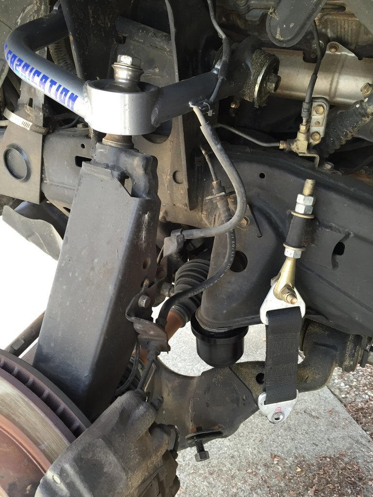

    Took my coilovers out for rebuild and added super bumps.

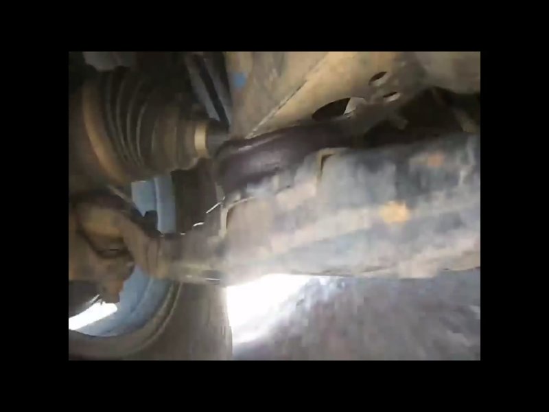

    When you cycle your suspension and take your measurements, keep in mind those bumpstops compress a lot.. Here's a good vid showing them in action in case you haven't seen it, along with the best screenshot I could grab at full compression.

    i've seen that and thats why im curious. Ill cycle it the best i can but i put two washers to space it down so im hoping that will do the trick.
