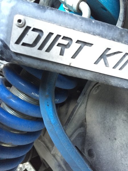

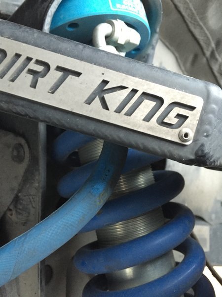

    Anyone else have this problem?

    I haven't seen that before, but its most likely because they changed the way the resi mounts. Now its vertical versus mine is horizontal, yours brings the hose up more. Maybe the DK uppers are bigger than other aftermarket UCA's causing the rubbing?

    I was thinking the same thing.
    In the mean time I wrapped the hoses with abrasion sleeving.

    Move your resi's closer to the shock, like slide em in the mounts, so the hose has a steeper angle

    He has the new vertical style so he can't

    Ohhhhhhh I gotcha....shitty
