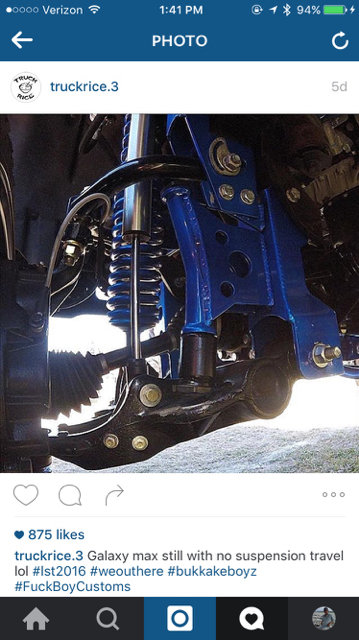

    Saw this picture and realized it's hilarious. He has no uptravel or downtravel at all. 4f8d16e7036599f1f530f5dc04242549_e3e166429619b49b232285c0f2edb6a2afba5bb9.jpg
    Edit: I know it's not mid travel but figured y'all would get a good laugh.
