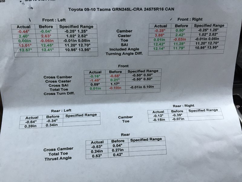

    I just the got the truck aligned to try and get more caster to clear a bit of rubbing.
    How did they do?

    I notice that appears to say Canada on it. I'm not sure if that messed with the numbers but if I base it on our measurement system I would say it looks like they did a horrid job adjusting it.
    It looks super biased on the right for caster and will have you wandering HARD to the right.

    So do you think I should take it back?
