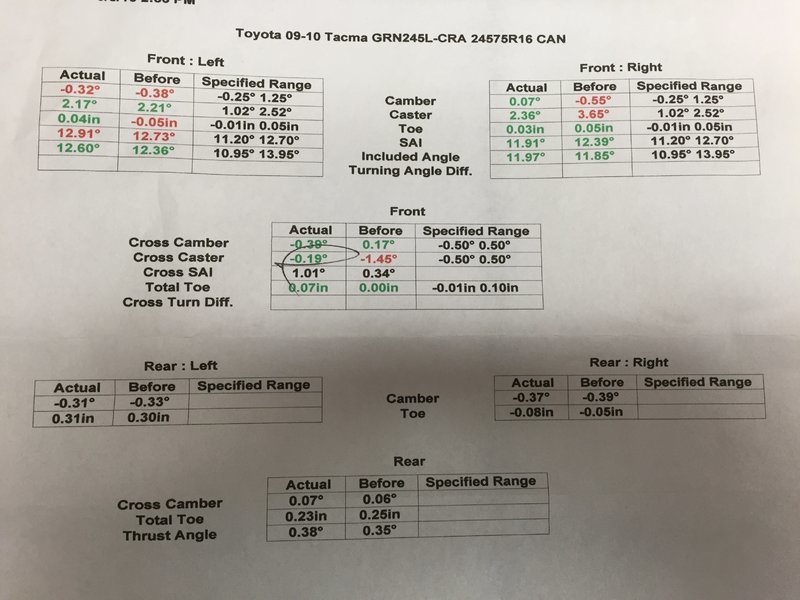

    Caster is the relationship between the upper ball joint and lower ball joint and what ball joint is leading. In almost all situations the lower ball joint should be leading the upper ball joint. Because of this relationship, the height of the rear of the truck plays a huge roll in the amount of caster a vehicle can have. A truck with the rear suspension higher then the front will have a harder time getting higher caster numbers then a truck the rear lower then the front. My truck sits slightly high in the rear and 3° is about where it likes to sit.
    When I align a vehicle I tend to set the camber equal from side to side, close to 0° depending on lift height. I give a 15 through 25 minute caster lead to help with road crown, though the vehicle will still drift right. Toe is usually around 3mm in. A little negative camber is good after lift because these trucks usually go positive camber under suspension compression. I don't usually have equal caster because constant pull correction usually makes drivers unhappy/fatigued over long trips. If you take your hands off the wheel and the truck drifts left or stays straight, that is wrong, it should not pull right though.

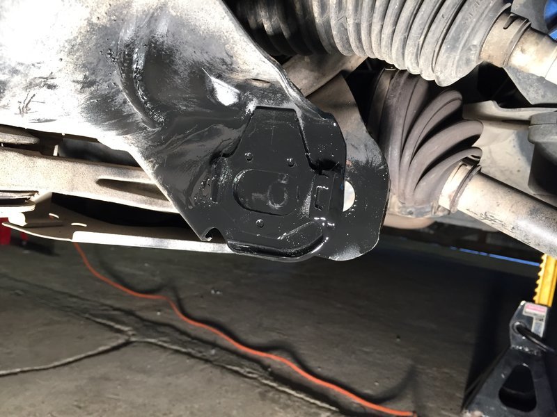

    Well truck was driving so weird, and since it's my DD, I couldn't wait to order the TC kit. I just ended up using some 1/4" bar stock, straightened the tabs and welded it all together.
    I'll drop off tomorrow to get aligned again and hopefully be good for now.

    It's not a huge deal. I have flat alignment cam tabs as well on mine on both the front and rear portion of the drivers side LCA's and I was able achieve the results I wanted (with the help of an icepick of course to shift the LCA some so I could adjust caster) ;)
    I have since wheeled the living fuck out of it, gone airborne more then a fair amount of times and the caster nor camber has not moved once. The toe on the other hand is the one which really pisses me off.

    I'd like to see your alignment results before and after offroading lol. I had one flattened cam tab and my camber was never in spec again. Well, it was, since the guy bent the tab back, but the first time I went offroad my alignment went to shit again

    I check my alignment periodically.
    3.0* Caster driver side
    3.3* Caster pass side
    0.9* Camber driver side
    1.0* Camber pass side
    The stuff has never moved since I installed my control arms. It will need to be moved once I re-lift the truck again in the coming days this week, but as of right now I drift slightly right because of the caster difference. It annoys the hell out of me, but the tires have been wearing well, and even.
    Toe is set to where it needs to be. Always moving of course and my steering wheel is always fucked up because of shitty steering rack bushings.
