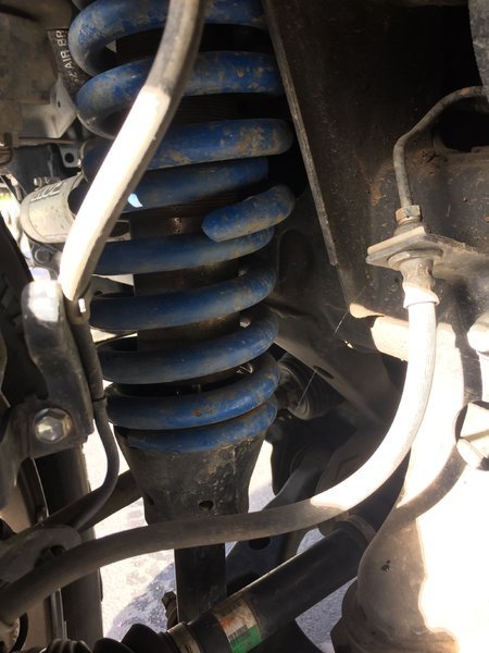

    Has this happened to anyone else? A little over a year ago I put 700lb king coil springs on my fox coilovers and this happened....IMG_2163.jpg

    #1610

    deadhed61 :notsure:

    Coil bind?

    Coil bind.

    Thank you but I'm just going to bite the bullet on another coil
    Thanks, and how do I avoid that from happening again?

    Proper coil or less preload.

    Couple things. What is the height of your coil uncompressed? 13 or 14"? You have to determine what the max compression limit is on your springs before coil bind. You also hve to determine how much travel your suspension setup is capable of allowing. My suggestion is just go with some Eibach ERS springs as their block height (full compression before bind) is displayed on their info when purchasing their springs if you buy it through Polyperformance.com.
    Example. The most my suspension allows for is for 5.5" of shock shaft travel before full bottom out. I have a 14" spring. Block height on it is 7.02" and travel is 6.98." The most I can crank on my top hat before I experience coil bind is 1.5."
    Of course I regularly stuff my suspension so it is necessary for me to use all of the shock travel and have the system setup correctly.

    I have 14" coils. I can't remember exactly but the shock travel is somewhere between 5-5.5". I'll look into the Eibachs for sure
