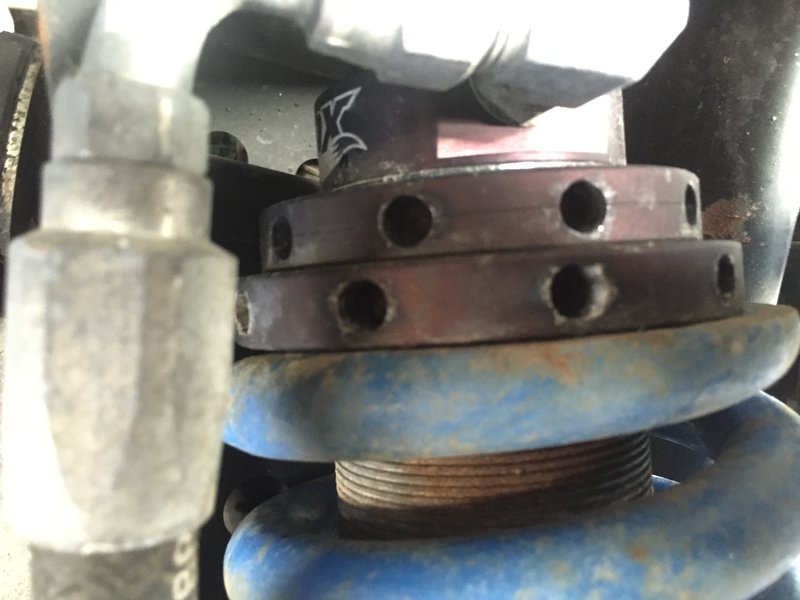

    How much preload do you have?

    I'm not sure if King displays all their tech specs on their springs, but any good manufacturer of springs will have those specs readily available. If they don't, then stray away.
    Stick to 14."
    Yeah, and as @ckeene9 said, how much preload do you have?

    Next to nothing

    did you have to compress them to install?

    Oh shit :O
    Okay, that's not cool at all… You know what, get rid of those springs entirely. You may have gotten a bad batch, or they were just horribly QC'ed. Go with the Eibach ERS's. 14" 3.0 ID 600-700#' (depending how much weight you got up front).

    It really shouldn't matter. The springs should be able to handle anything thrown their way as long as it's done within their manufactured limits. Unless you are getting at the fact that they went on there wrong and have been sitting incorrect the entire time?

    just trying to figure it out, because its very odd with zero crank.

    It is, I agree..

    They were compressed but nothing crazy. I think I just got a bad batch. Haven't abused the set up at all and haven't even been off-road since this summer
